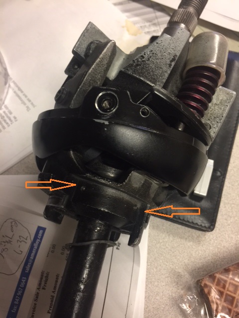

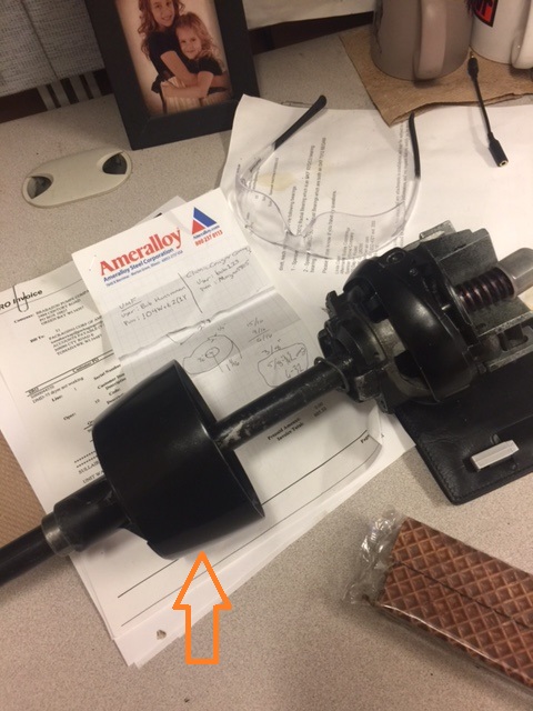

I’ve attached two photos of what I need reassurance on.
One photo has two arrows pointing to threaded holes, wondering if those two holes are used for set screws to anchor the first lower bell? The bell i’m talking about is in the second picture. Any direction would be appreciate it.
The picture with the two holes is showing holes for a gear shift indexer for a tbird or lincoln with tilt/tilt-away columns. The second hole is a drain hole for moisture the best I can figure as nothing mounts to it.
