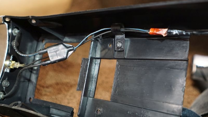

Those with access to multiple consoles and/or experience - Have you notices an issue with the mounting bosses of the harness loops underneath? Only 1 of the 3 bosses was tapped to allow the loops to be mounted. They were just screwed in adjacent to the feature. Even with short screws a lot poked out the top. With great care I added two new pilot holes. Now the screws poke out but a fraction of like before. Pad covers everything anyway. Guessing it’s just be one of those old factory things.
Both of my harnesses have 3 small white plastic mounts that get pushed clipped into 3 holes Going down the length of the console.
I’ll take a pic of them when I switch out the blinking shift light from my console later today.
Cool. It will be interesting to compare consoles. I usually take pictures of everything before taking it apart but skipped this somehow.
This clip was hanging on the wire harness for the clock/rear courtesy lights. Does it belong? If yes, where?
That one was up front behind the clock on mine.
