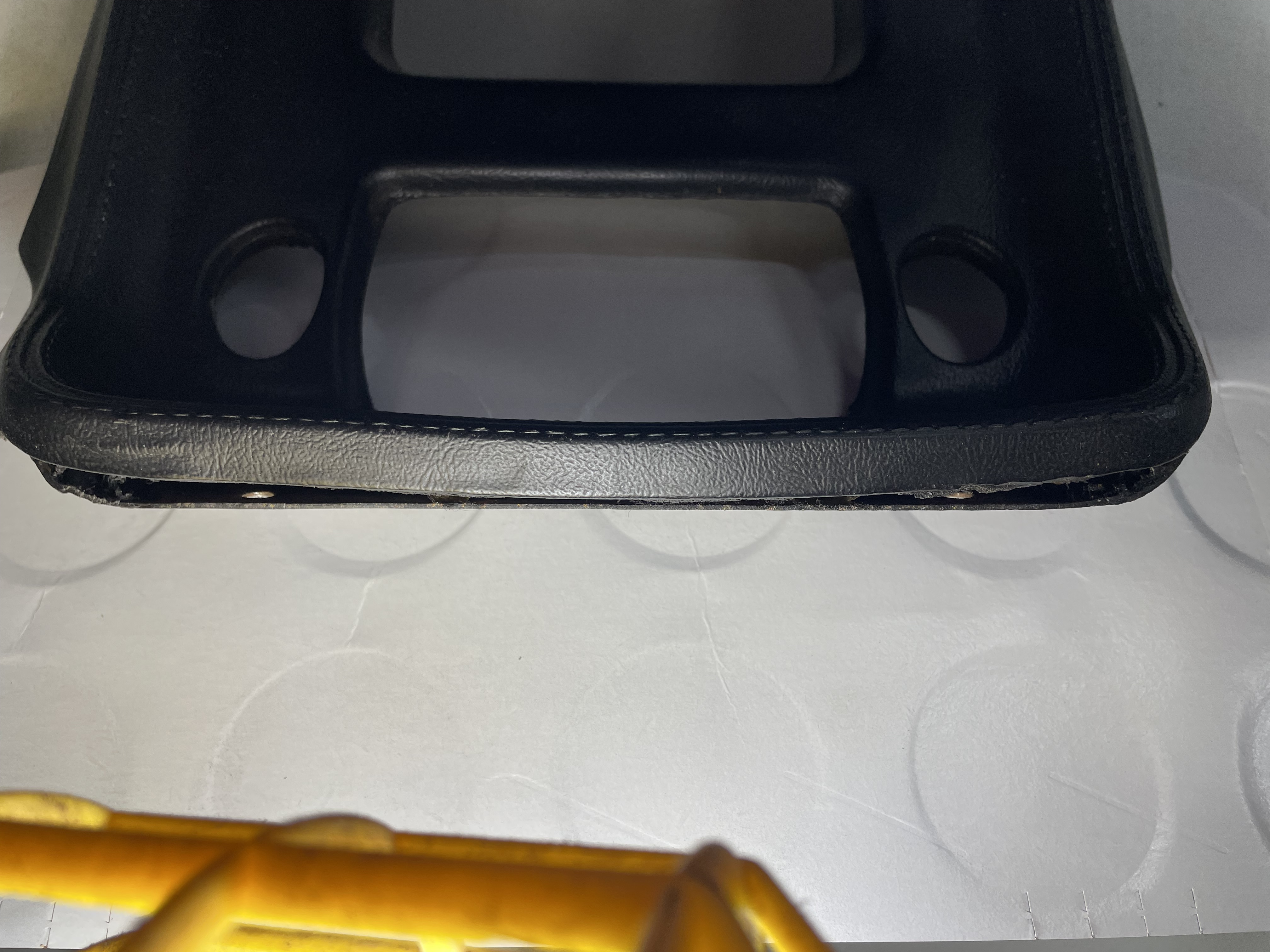

1968 console radio pad

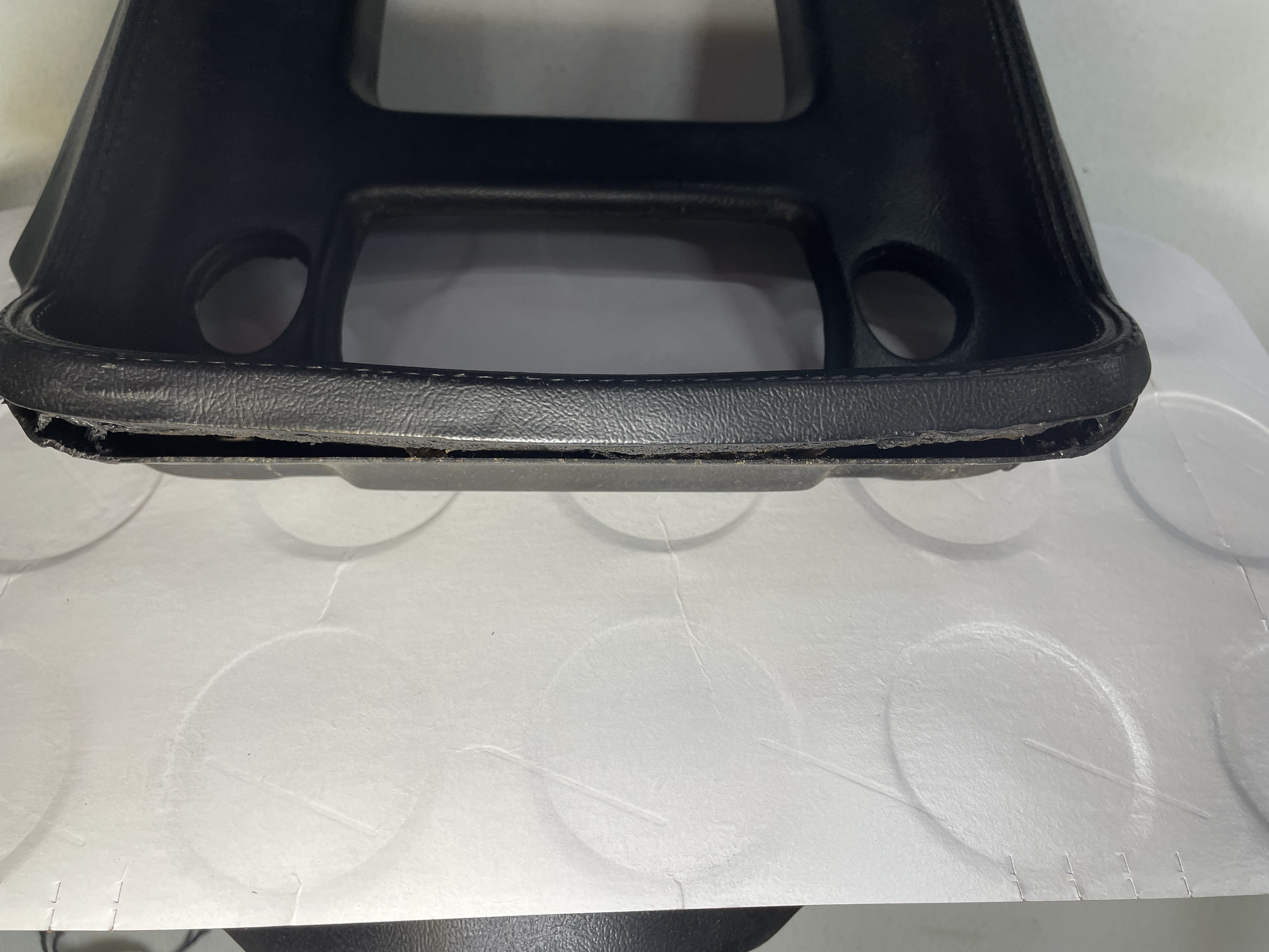

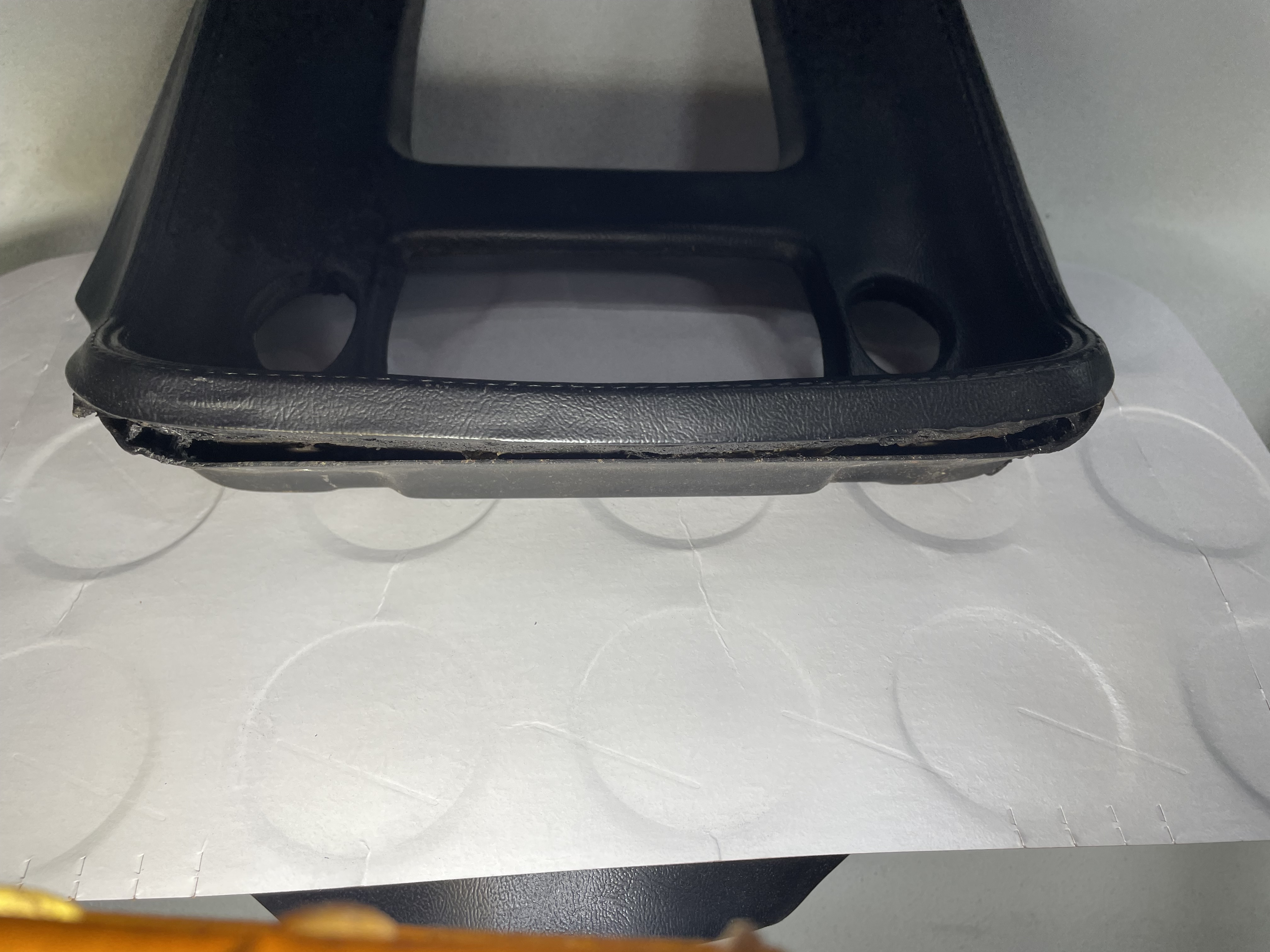

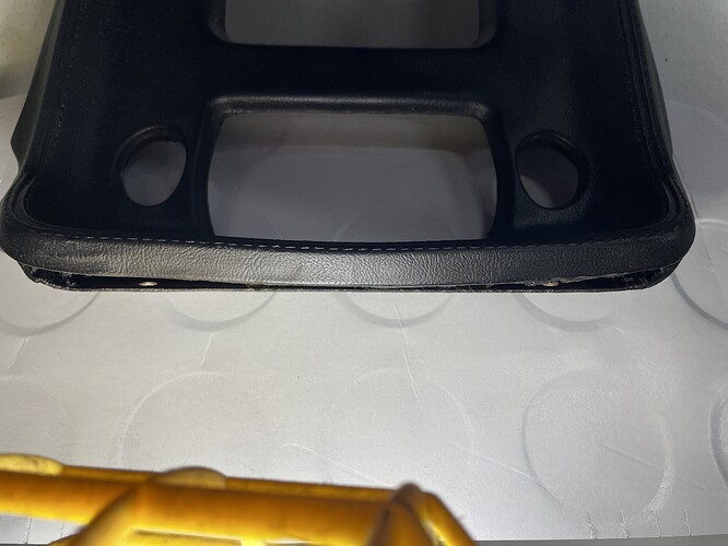

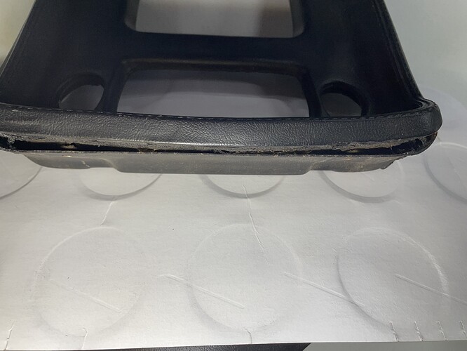

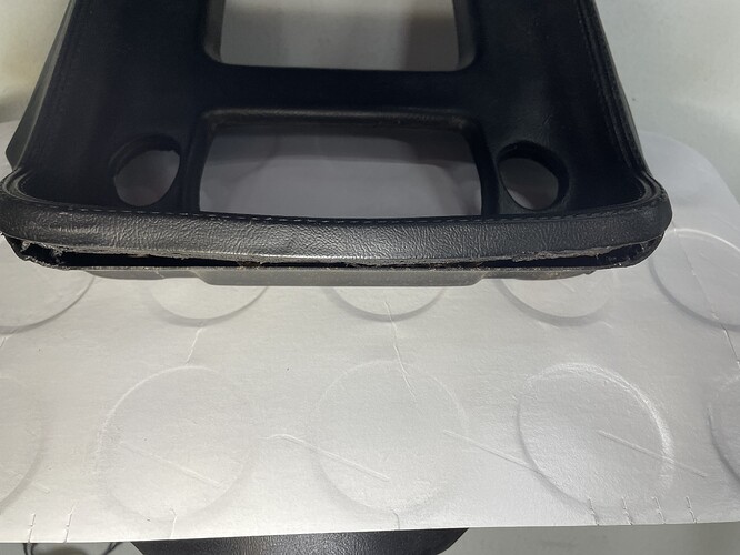

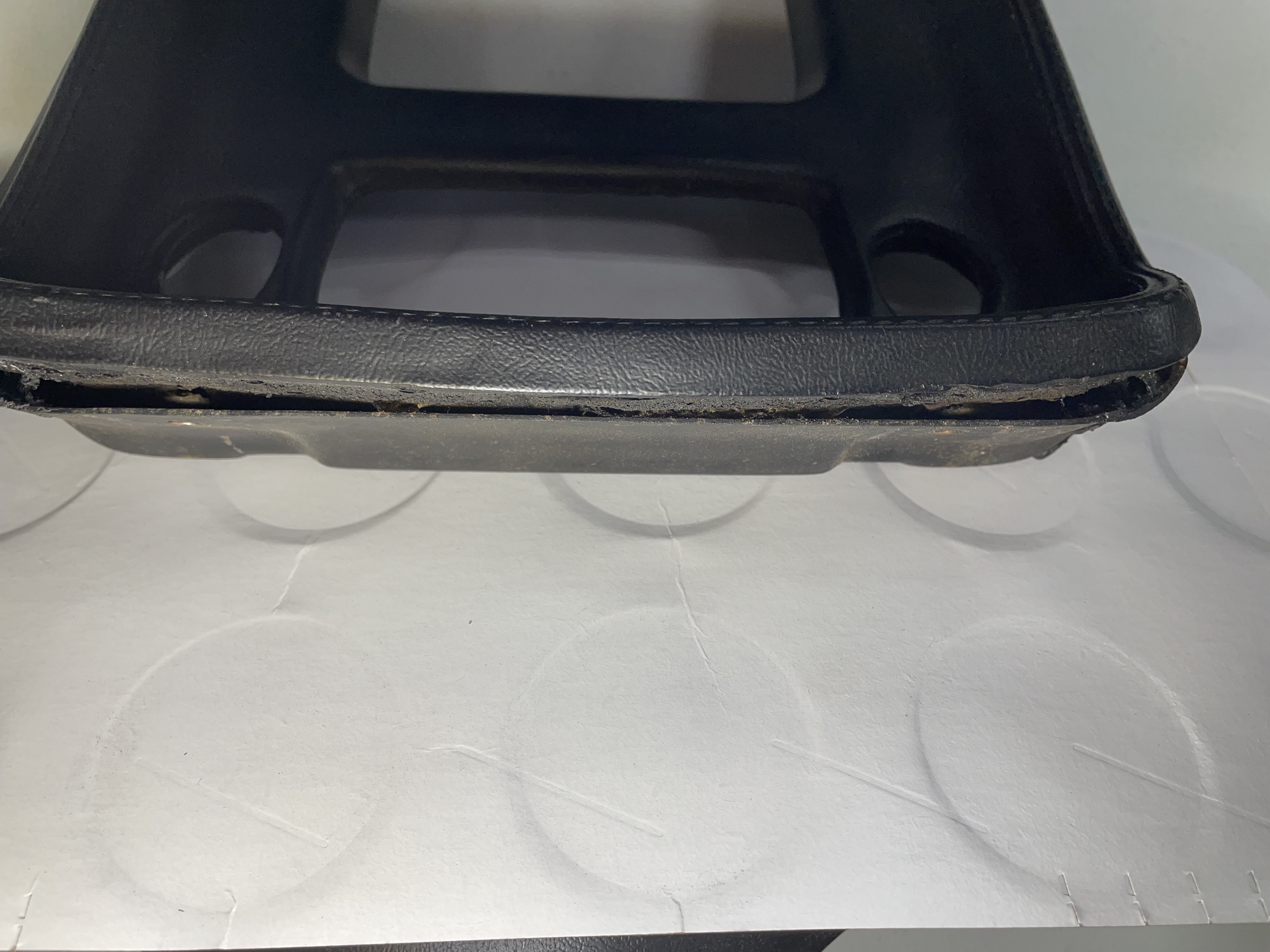

​I couldn’t find any posts about this with the search. Has anyone successfully re-fastened the pad to the metal. Don’t remember what I used but it didn’t hold.
I have used 3M # 1357 Contact Cement. I first removed the foam in the area to be glued. Then applied the adhesive and let it dry to the touch. Then stuck it. That was 24 months ago. Still stuck.
Thank you, I will give that a try.

I used JB plastic weld on mine crzycat but neeed to clip till it sets up
