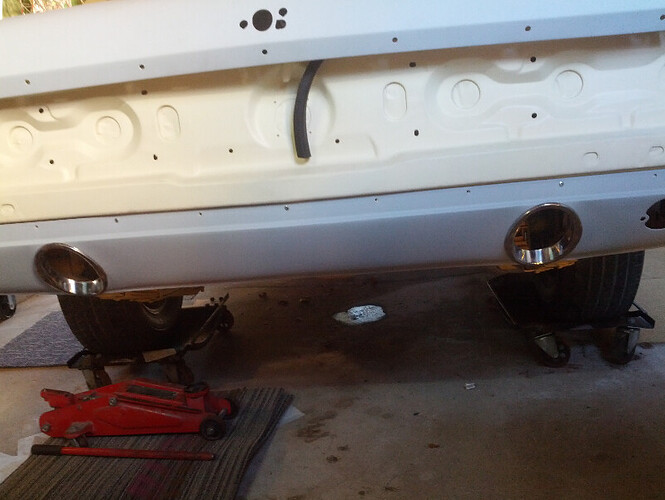

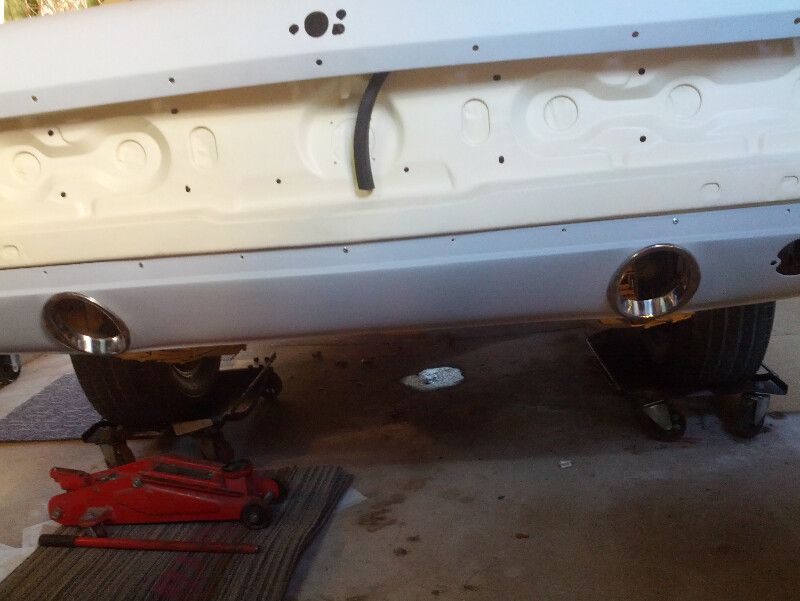

Here are a couple of pictures of the Trumpet Tips that I will be using for the “GT-E prototype look”.
Great job on polishing the lenses!
