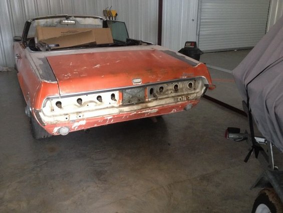

I pulled the valance, taillights and rear bumper yesterday.

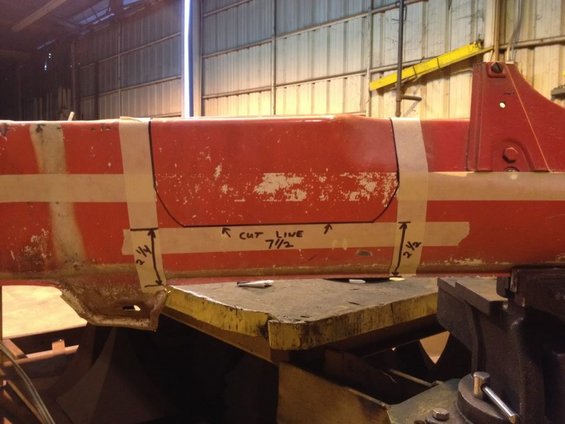

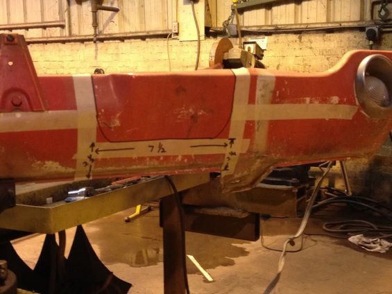

Today I started mocking up the front valance for the fog light bucket modifications. With the curve and shape of the valance it took a little longer than I expected to get everything laid out. The measurements I used are shown in the photos and seem to look good with my Lucas Square 8 lamps.
I cut the valance on the passenger side and checked my fog light bucket mock up for fit. It seems to fit pretty well so now It’s time to transfer my mock up template to steel.

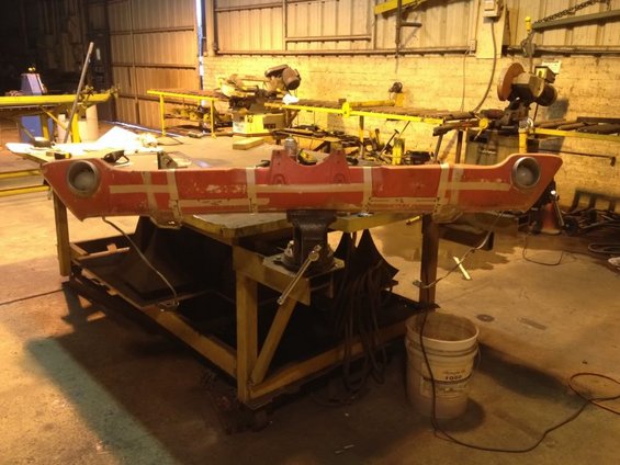

I did a test fit of the valance today. The fog light buckets cleared everything so I removed the valance and its back to the welding table for the final welding.
Maybe it’s just an angle in the above photo but the bucket on the right looks to be closer to the center of the valance than the bucket on the left. Based on the drop down in the bumper and its relationship to the top of the bucket.
Randy you are correct. The buckets were worked off of the centerline of the valance so they are good. The bumper needs to shift over about 5/16 of an inch towards the drivers side. The car was hit on the passenger side at some point in its life. The bumper brackets/bar still is bent. After that fix is done the drop down in the bumper for the license plate opening will look better. I also didn’t have the valance completely bolted in place when I took the photo. My main reason for the test fit was to make sure the backs of the buckets cleared the bottom of the radiator support.
