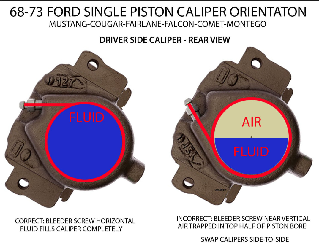

#1 thing to check - verify that your calipers are installed on the correct side of the car. The bleeder must point to the rear of the car. If it points upward, you cannot get all of the air out of the bore.
