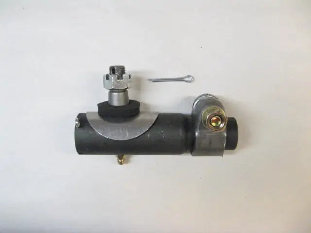

Can you eliminate the assist steering cylinder and all the mess of hoses without converting to manual steering?
If you eliminate the slave cylinder and the hoses you have converted to manual steering but you still have the pump and the control valve in place so steering will be imprecise and not powered.
This is what you will want if ditching the hydraulic assist cylinder

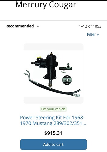

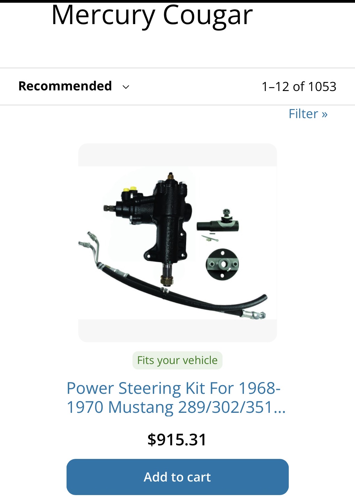

Would the Bergson steering box eliminate all of that
A borgeson gear box is a hydraulic unit so you’ll still have a pump, belt, and fluid. But you get to eliminate all the slave cylinder and control valve that hangs underneath
What Borgeson gear box unit did you get?
