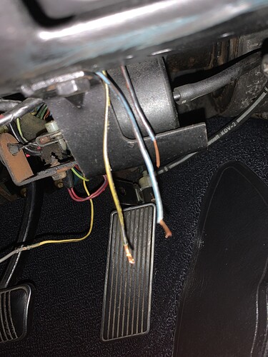

I got a ‘68 Cougar Base. I’m installing a new radio, which (obviously) requires power. The manual comes with a red wire, and a yellow wire. It says to “Connect the red wire to an accessory fuse that is switched OFF when the key switch is in the OFF position and is switched ON when the key is switched to the ON or accessory position.”
For the yellow wire in the new aftermarket radio kit it says “Connect the YELLOW wire to an accessory fuse that is always ON regardless of the position of the key switch. The lead supplies power to the program memory and the clock circuit when the radio is switched off.”
I’ve already prepared the wires that came with the car, but I don’t know which wires go with the new wires in the radio set. The car already has 2 blue wires with red tracers, and one yellow wire (originally being the female end for the original radio)
I just need to know what wires in the picture go with the new red wire and the new yellow wire in the radio kit.
The yellow/black factory wire is keyed power; the blue/red wire is for dash lamps. For BATT power, splice into the cigarette lighter (blue/white).
