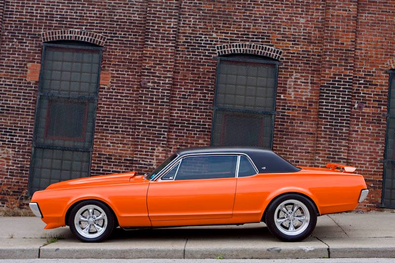

I did the one inch drop springs and the Shelby Drop.
I like that stance that you have achieved. I was hoping to not drill holes to do the Shelby drop. If it is not too much trouble, let me know if you can measure from the wheel center to the top of the fender’s wheel opening on both front and rear, as you have about what I am trying to achieve. Thanks
14" Front 15" Rear

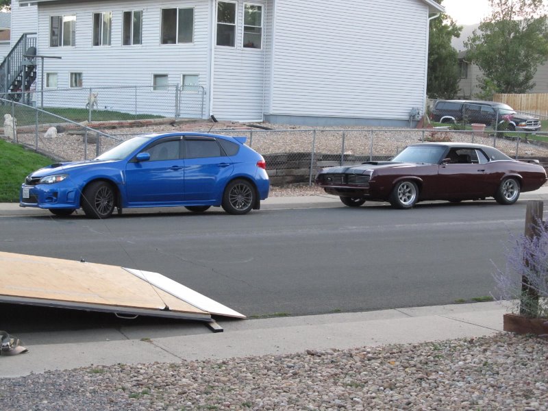

Others frown upon the practice but I cut partial coils up to a whole coil or even more out of the front springs on all my cars. Some of my cars also run staggered wheels such as 14" fronts and 15" rears.
My cougar runs 17" fronts and 18" rears with 2/3rds of a coil cut out of the 620 lowering front springs.
Since that picture was taken, I’ve recently replaced my entire front with Total Control Products tubular upper and lower control arms, strut rods, sway bar and tie rod ends. It made the front now too low with those same cut 620 springs. So I’m shopping coilover shocks now that are adjustable.
I realize my set-up is likely out of reach for the average guy, but I’ve had this car over 40+ years so I look at the cost over the long haul and it’s not too bad. :whistle:

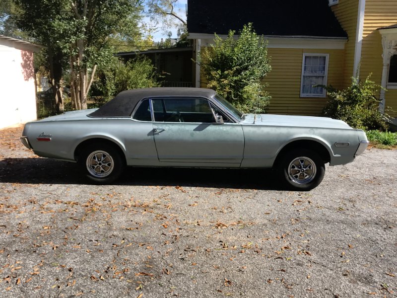

Thanks for all the input and some nice rides with great stance. Here is the rather awkward nose up stance that I am dealing with. The shadow helps hide just how much opening is in the front wheel wells compared to the rear. I know the squatted truck’s are hot right now, but I don’t want that look on my Cougarhttps://classiccougarcommunity.com/forum/download/file.php?mode=view&id=24925
Just wondering, is that diamond blue?
It was a repaint years ago by previous owner. Not sure what color used, but it is not factory. How about the '68 on the classic community landing page? What color is that? Looks like some kind of Turquoise
