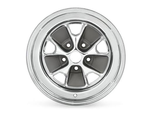

I have my wheels picked out. Scott Drake 15x7 styled steel wheels(Mustang look). Part # C5ZZ-1007-CR. According to the Holley website, backspacing is 3.98", but Summit lists the same wheel with a 4.25" backspace, so I’m not sure what it is.
I have been unable to find a vendor that makes a trim ring for these 15" wheels. Perhaps they never made one. I believe you can get a trim ring for the same wheel in 14". Any thoughts?

It’s a chrome rim, so not envisioned for trim rings.
The 14" version of this wheel has trim rings available
Why would you put a trim ring on that?
OEM SSW’s have a black painted rim, thus covered with a trim ring.
I see. Thanks. I want a trim ring to make it appear more original to the factory issued wheel. IMO the trim ring finishes off the wheel and counters all the chrome bling(aftermarket look).
Perhaps I will switch to the 14", albeit less tire choices.

Thanks for the link. I wonder if the original trim rings had a rounded edge or a tapered edge.
