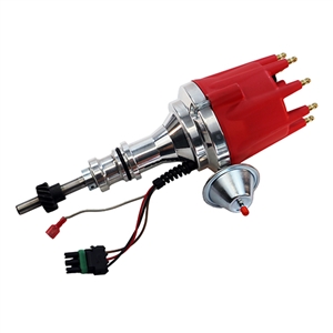

Hey everyone I just recently put in a performance world distributor (run ready)and I’m having a hard time trying to figure out how to get my rpm gauge working again as there was only one wire comming out of the old stock distributor going to the ignition coil witch to my knowledge was the one powering the rpm gauge. Any help would be greatly appreciated thanks.

Here’s a link to the distributor I put in if that’s any help

Looks like you bought a Chinese made distributor. Likely it has a Pertronix imitating device that makes it incompatible with the stock current type tachometer. Bob can modify your tach to work with this type distributor but the quality is so low that the likelihood of it lasting much more than for a drive around the block is pretty low.

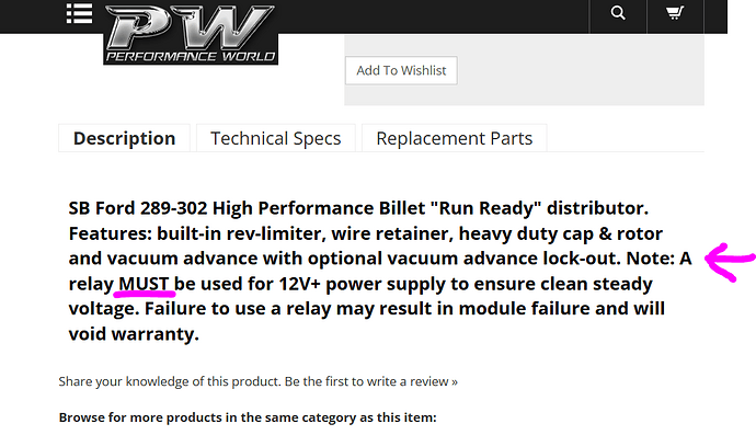

Before you rip your dash apart to send Rocketman your tach, how are you powering the distributor? Did you use a relay as they warn must be used? You can power the coil itself through the original (+) lead, and with the 12V relay powering the distributor module, your tach should function as normal.

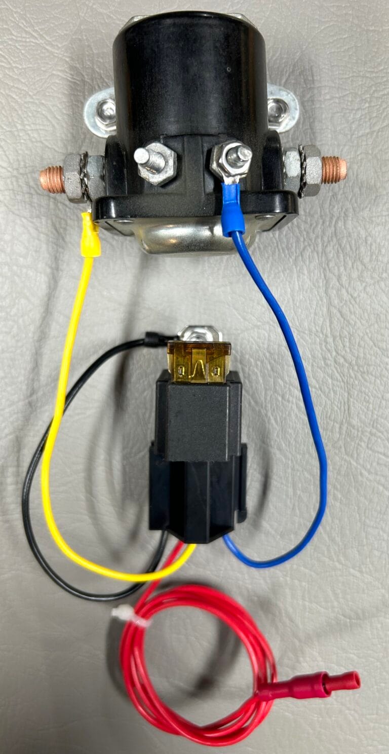

here is the relay
Yes I installed a relay just having troubles finding the wire to power my rpm gauge
