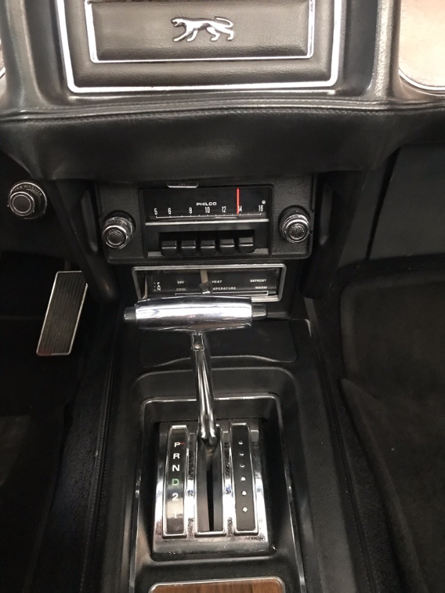

Hey guys I’m still a little confused. I have the original am/fm radio and want to get an improved modern version (if possible) for the dash.
Should I get the JBL listed in this thread?
Do I need to buy additional bass blockers?
Will I ever figure out why peanuts are neither Peas or Nuts?
Sorry for the questions. Pretty lost and don’t want to make the wrong purchase.
I went with a radio from retrosound. If you don’t mind that it is not original, but at least looks like a radio from that era, then I would go with this as the replacement radio.
https://www.retromanufacturing.com/products/1967-73-mercury-cougar-hermosa-radio?rq=yr_1968~mk_mercury~md_cougar&variant=9368467459
To answer your question, yes, the JBL speakers will work great with the modern stereo above. You can try them with/without the bass blockers and compare your results. You will need the 3.5" plate adapter from WCCC as well.
Yes the JBL speakers should work great with a modern stereo. But they are only 3 ohm speakers vs. 8 ohm that the original radios are designed to drive. I am still trying to figure out best retrofit speakers for original radios - and peanuts too for that matter. Those Turnswitch.com speakers in the post from R.B.Phillips look interesting.
Also consider a modern alternative all together. Single Din “media” players are pretty cheap now days. basically it plays AM/FM and Bluetooth or USB input. Or you can get one with a CD player if desired. The bonus here is easier interface, more wattage per channel and more common 4ohm speaker outputs, Amp preouts etc.
Only negative is they may not fit your look inside the car.
Check out turnswitch.com he has conversion ability for your original radio to give you an “improved modern version.
