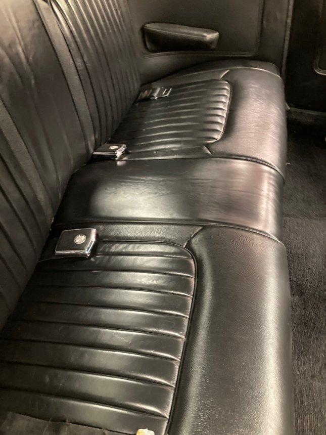

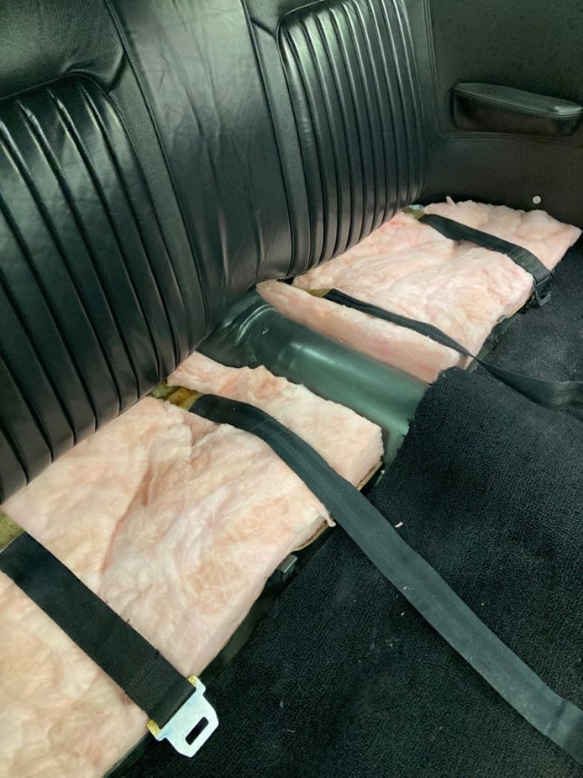

Started out the day with a trip to Home Depot to buy Fiberglas insulation to go under the back seat lower cushion. The original stuff was yellow, no one seems to carry that color so I got pink.

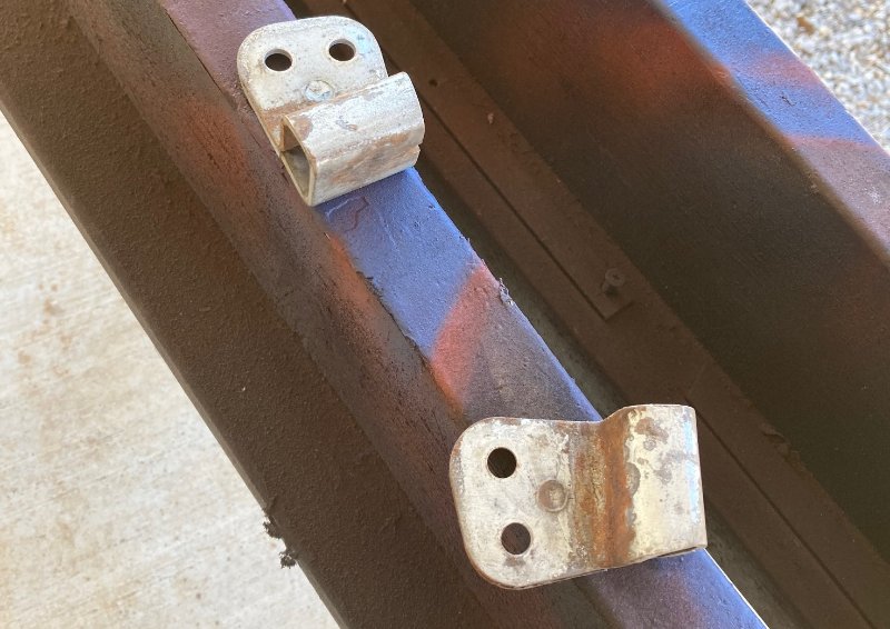

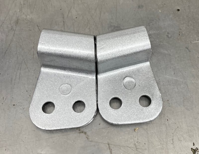

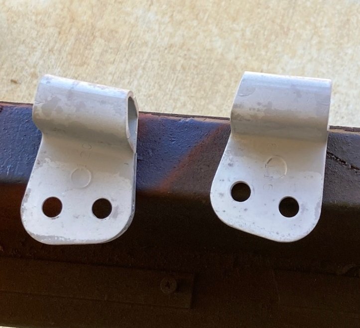

The front seat back latches were rusty so I bead blasted them and painted them matte silver. Then had to body work the seat pans because the holes were wallered out (thanks Randy C for helping). Cut the Fiberglas to size and finished the back seat today.
The yellow fiberglass insulation was Johns Manville ( and yes that’s the correct spelling ) - https://www.jm.com/en/building-insulation/
Looks like it is available here in town - I will use it on the next one for sure. Thanks!!!

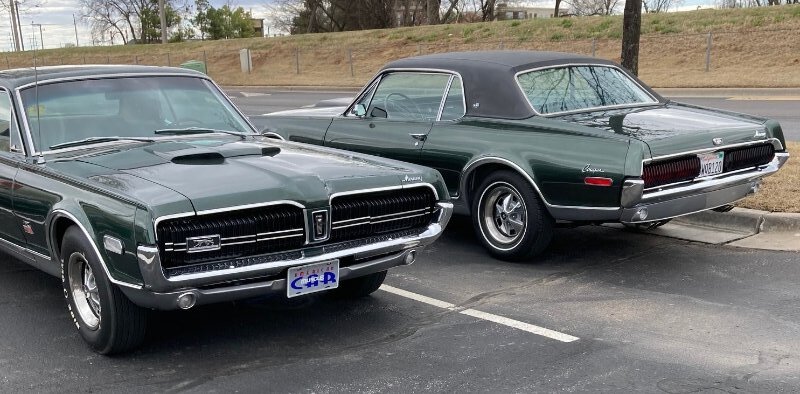

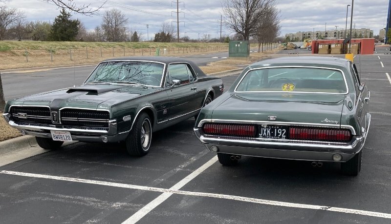

Finally today the owners got to drive the car for the frst time. We went to lunch, I drove my W code GT-E which was restored 25 years ago by me. It was a fun afternoon.
To see one in a parking lot is rare enough, but 2, in the same color is just priceless. Nice work Royce. I’m sour the owner will be pleased each time they take it out.
That’s really cool, Royce.
I am surprised that you left the mirror upside down.
Crap that’s going to be fixed ASAP. Thanks! Sometimes I can’t see the forest for all the trees.
I feel better now - I did the same thing on the cover illustration I did for Don Skinner’s GT-E book!
I think I corrected it before it went to print, but it is still upside down on my posters - or vice versa.
And yes, I would have a coronary if I ran out for lunch and saw two pristine GT-Es in the parking lot!
