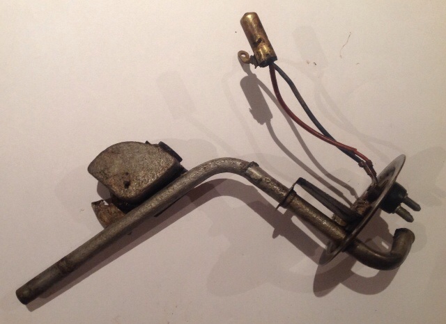

The fuel sender actually cleaned up ok once all the crud was removed. The exterior is nice and complete, the inside tank portion has some surface pitting, the filter was very brittle and fell to pieces, the float was completely gone. This is actually very close in configuration to the Dorman unit, except for the single versus triple plug.
Looks like you need a few parts. The arm for the float is missing as well as the float. You will also want to pry the tabs back and open up the sending unit as it will need to be cleaned up inside. The thermistor will also need to be replaced. It is soldered inside the brass can. And finally you will need to re solder the brass can to the tube.
