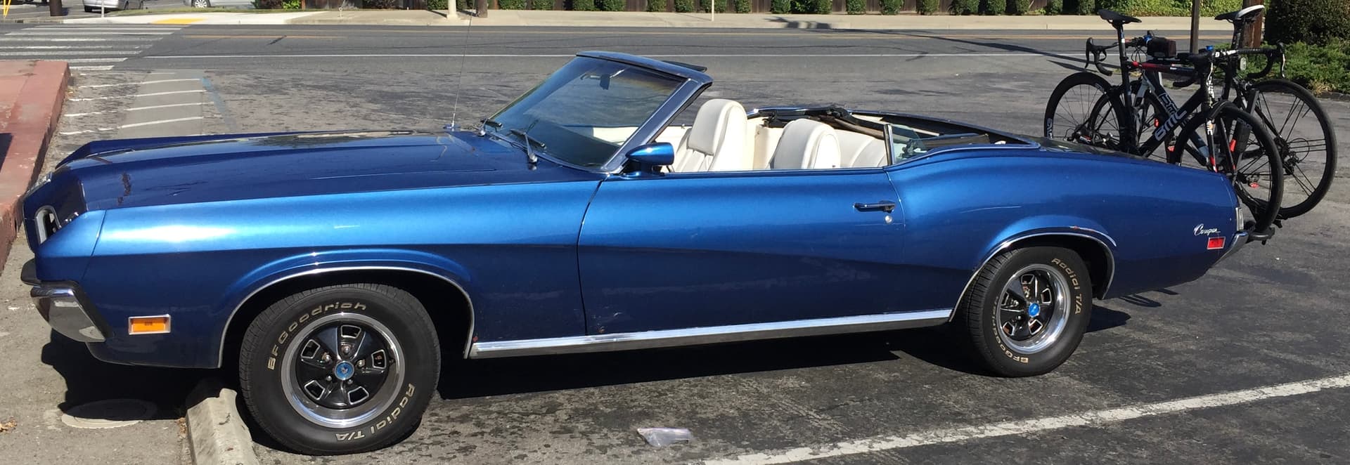

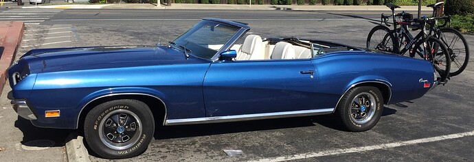

The styled-steel wheels on my 1970 Cougar XR-7 convertible are chipped and rusty in places, and need to be refinished. What’s the procedure? I imagine powdercoating is better than painting, so take them to a powdercoater, to be stripped and powdercoated. What’s the correct color? My wheels seem to be painted much darker than what I commonly see.

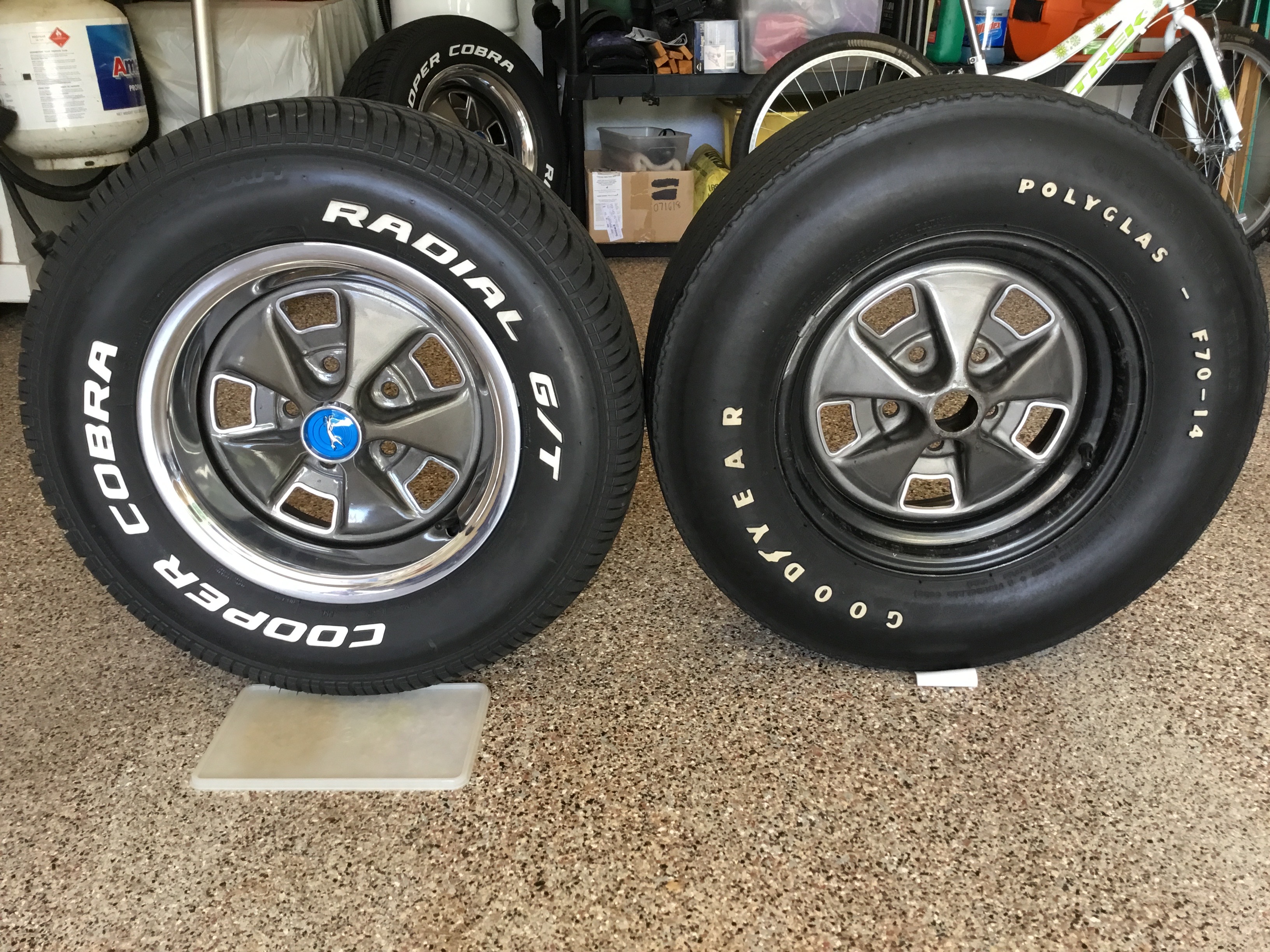

Yeah those are too dark. Gorgeous Cougar though! I removed the chrome opening trim, then sanded and degreased. Inspected very closely for loose rivets and fatigue cracks. Sprayed the argent silver first, then masked and applied semi gloss black to the rest of the wheel. Polished up the chrome trim and reinstalled. I used the paint that John sells and color is spot-on. My only gripe is the silver turned out a touch glossier than original. Pic is comparison between my original spare and a refinished wheel.

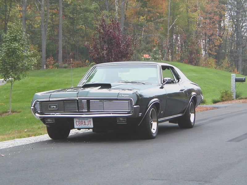

Maybe it’s me, but those wheels are AWESOME on the '69-70 cars! I might be biased though by my prior Cougar…
