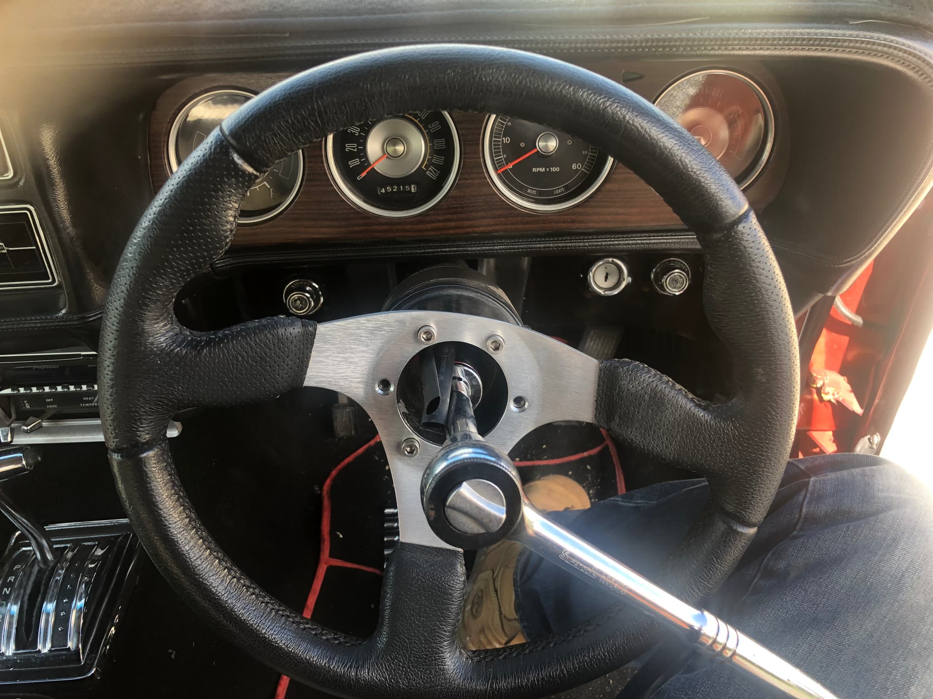

Kids bought me an interim cheap mahogany steering wheel for Father’s Day. I wanted to clock the wheel one spline anyway….
So I clocked my wheel, got it perfect … then I saw the new wheel had the opposite bolt pattern (bolt at twelve rather than gap at 12 o’clock) . Dang it!
Long story → short (I have just backspaced two long paragraphs about nothing much in exquisite detail) I wasted a couple of hours pulling off a boss for a wheel that did not fit, then having to re-clock the wheel 3 times to get it just right…

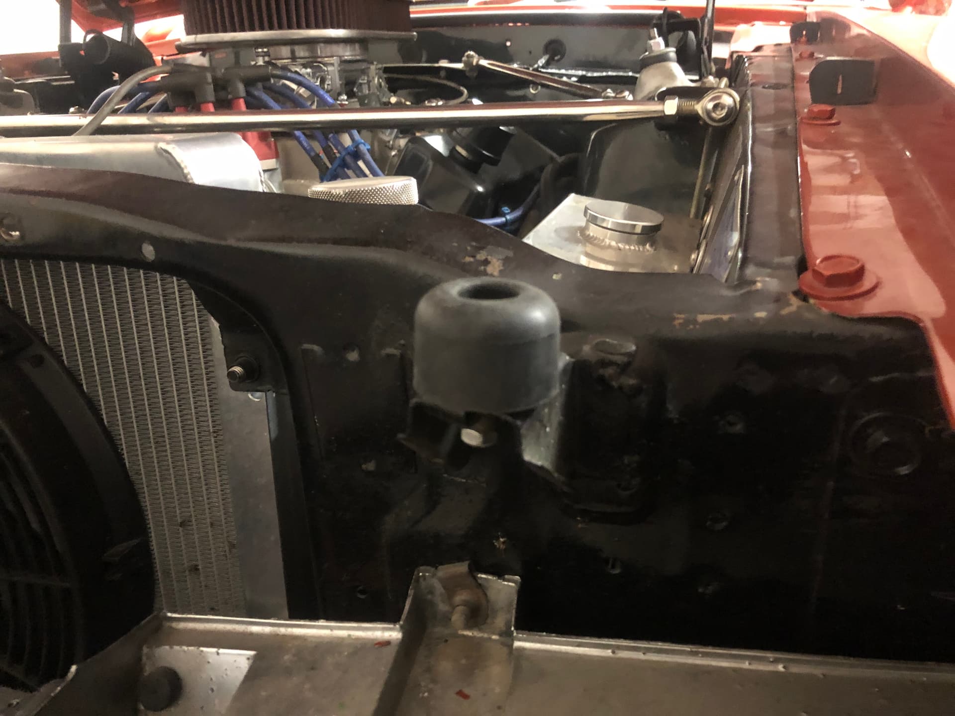

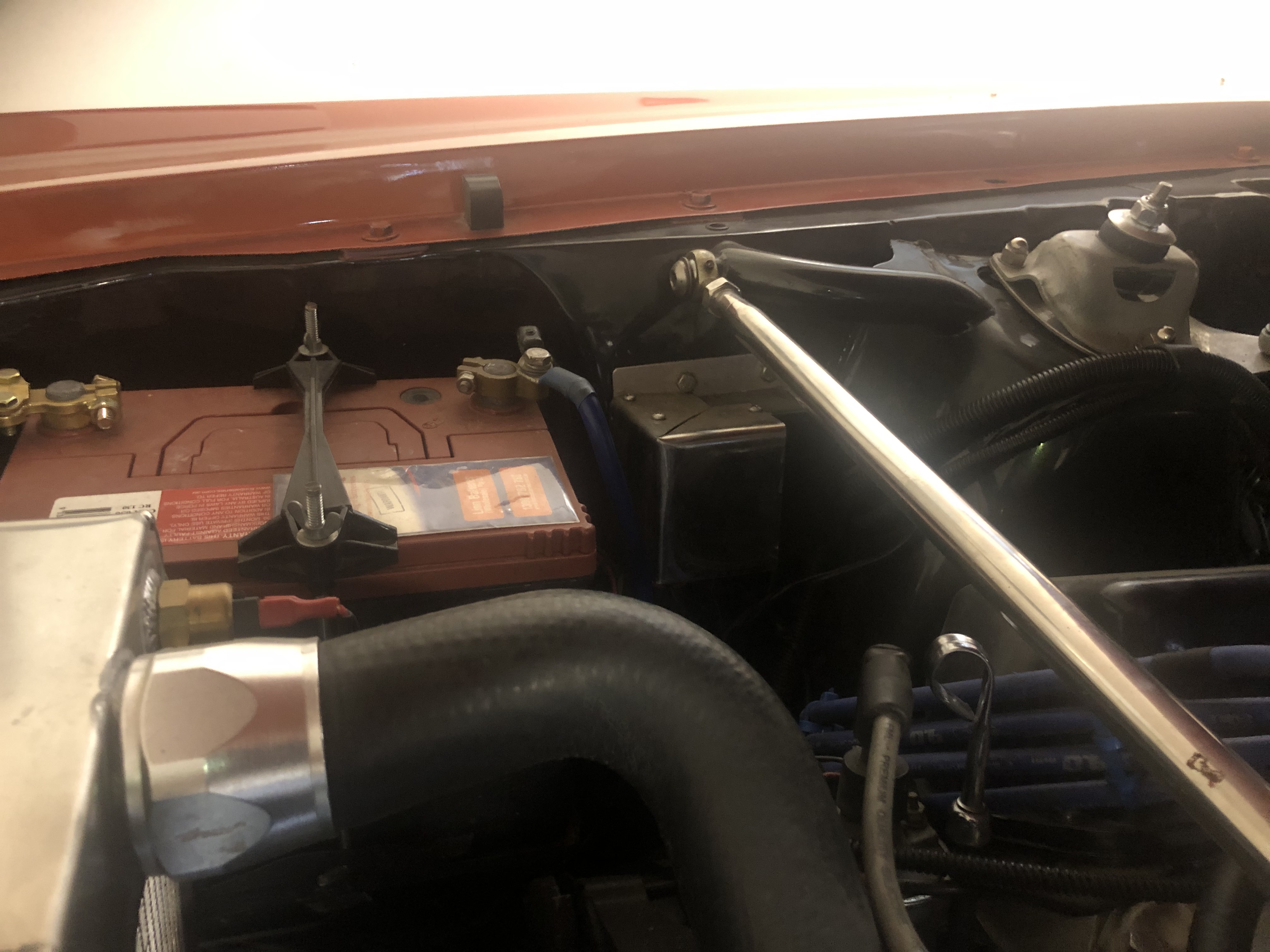

After driving it around bunch… I had South Australia All Ford day looming… and the bonnet (hood) fender line was bothering me… a couple of days out I thought… I can’t handle this! So I went and decided to pack it out with some window packers….
I feel dirty posting that… I am sorry

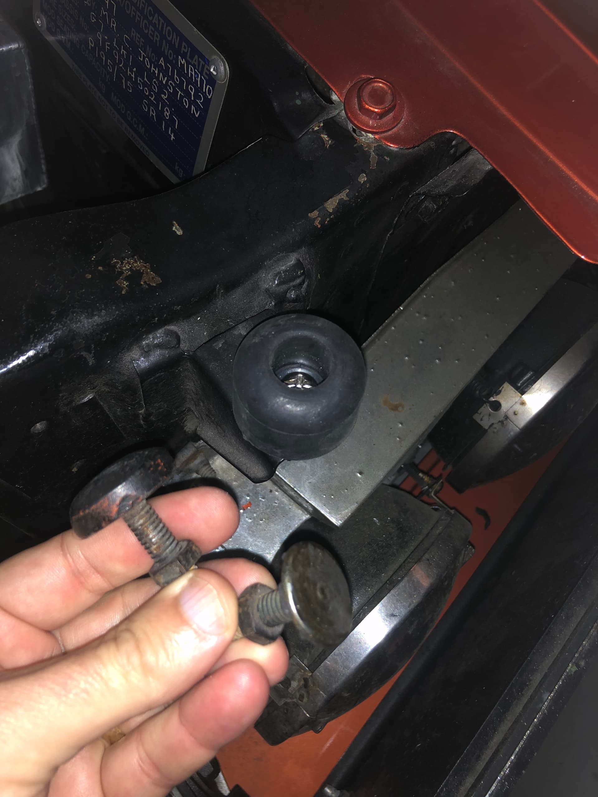

I had also flogged out the old Ford bonnet bumpers… I went to my local lolly shop (Outlaw Speed Shop) and they had some bumpers of the correct SAE thread (5/16?) and height but looked completely wrong … They wanted $100 bucks (OZ) for something that looked wrong… if it is going to look wrong I don’t want to pay that much, so a visit to Bunnings on the way home, and I knocked this up for $2.50…
Don’t do this at home…. Still a little way to go, but a lot better!

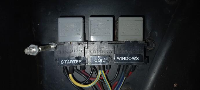

I had figured the starter solenoid ( the Ford can) was put behind a chrome cover to a) protect it from water (my scoop draws a tone of water if left open during rain) and b) neaten the engine bay. In three years I have never looked under it.

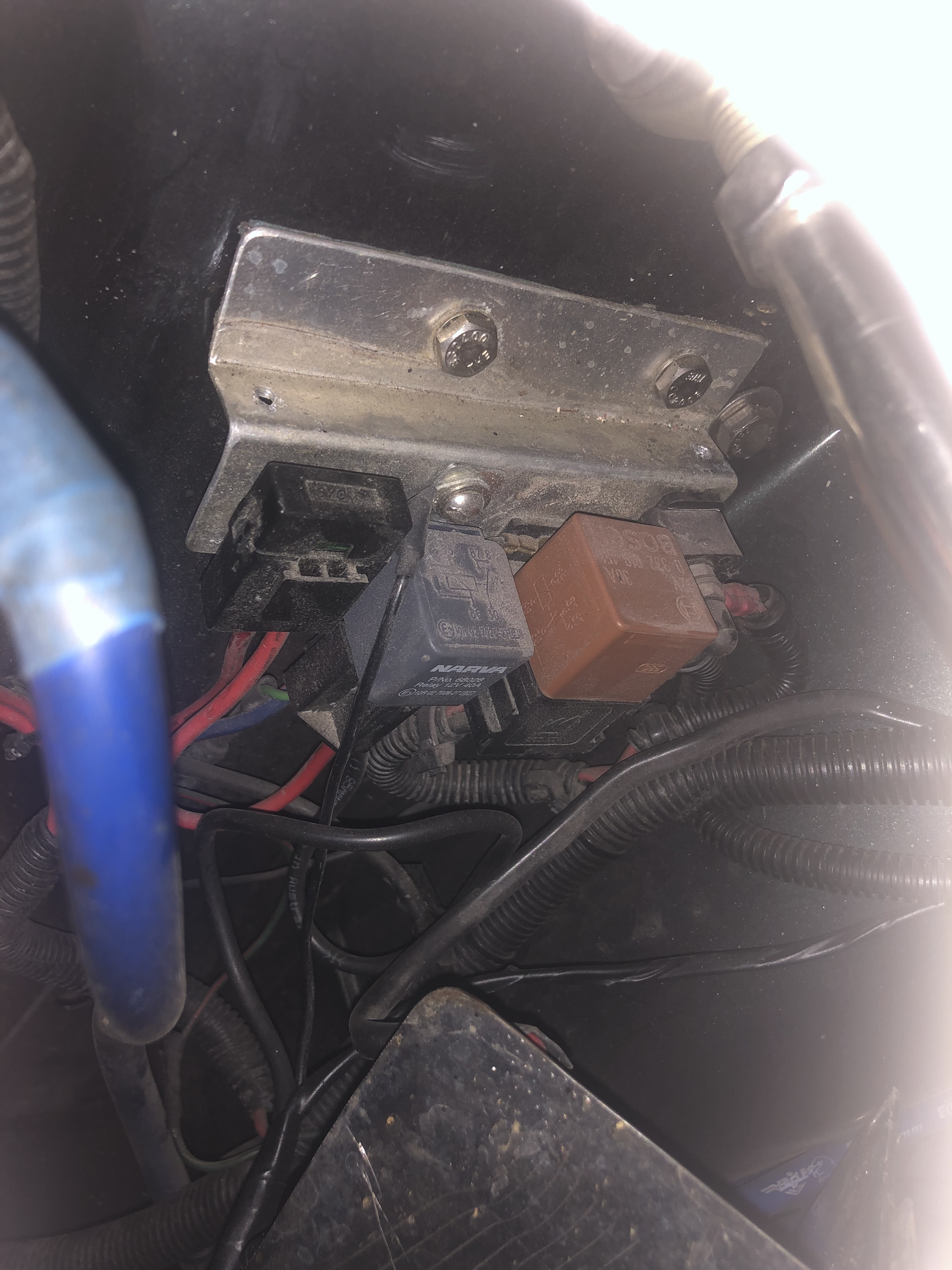

I removed it looking for a can and found this
What the? Anyhow . I replaced the control solenoid 40a and it didn’t fix anything.
Left it for a couple of months. This weekend we started tracing wires related to the starter circuit.

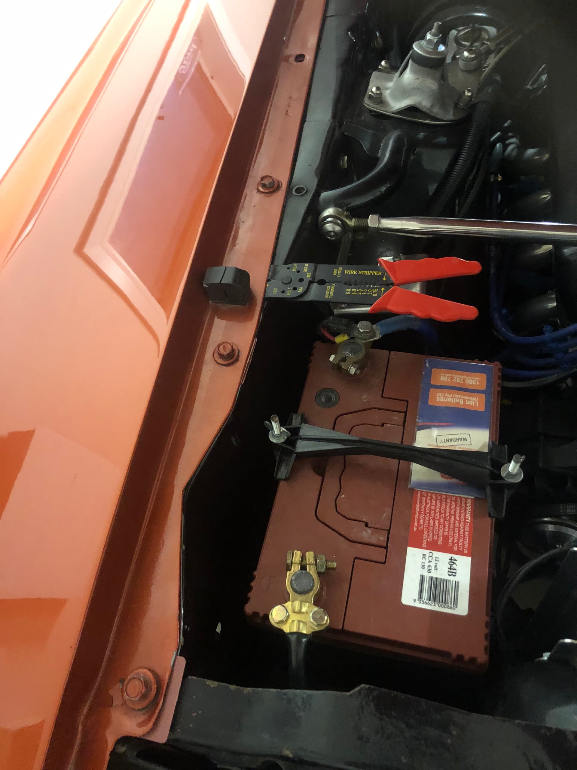

Everything I see electrically looks bad. The battery cables are a fire waiting to happen. Those bolt on cable ends are a disaster.

Whoever made those battery cables is not an electrician of any sort and those are not very old. Battery cables are preferably crimped or soldered. Those are going to be the cause of a fire.
This is a pretty normal mod when the clapper starter is replaced with the local Falcon unit. Normally done with 40amp relays from EA to EL Falcon
One relay is for the ignition start circuit and the other relay triggers the starter solenoid. Circuit breaker for top is on the end.
If you go back to the original style Ford starter solenoid you will still need a relay to trigger the starter solenoid, otherwise the starter won’t turn off when you release the key
In theory its not a bad setup to eliminate what could potentially be a hard to get part over there. Ie starter and solenoid. This is a more modern setup and with a little clean up can still be functionable, Its hard to tell from the pictures but most those cables appear to be crimped and have heat shrink so it might not be as bad as you think. I agree that negative terminal needs a proper connector and those corroded wiring replaced.

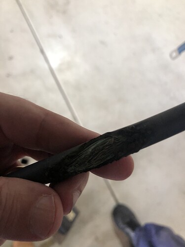

Ron, my local Mustang whisperer got to the bottom of it … excessive period (but incorrect model too long) wiring back from the safety switch at the gearbox selector draped onto my exhaust. It eventually melted, shorted and burned the wire bundle , locking on my starter.

I know someone has a “faint electrical burning smell” thread…. I too caught the occasional whiff, never strong though…

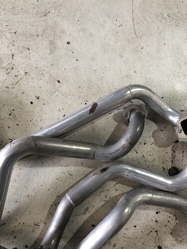

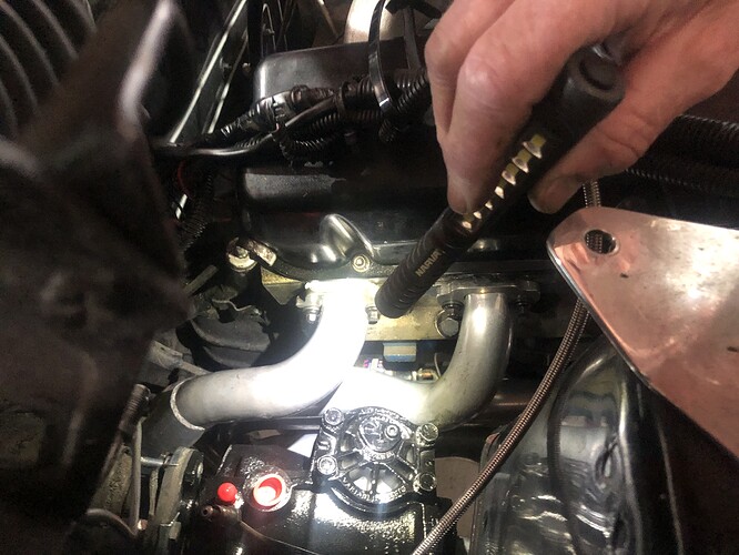

The scorch marks on my headers…. Main power wire had detached… and brushed on two of the tubes as the engine loped at idle…
I am hoping this is why my idle went bad!
The wire. Engine stopped it did not touch the headers. Burned but the evidence was underneath never saw it (super cramped on RHD driver’s side as booster and steer box are not usually there with the starter) … I am guessing the wire moved enough one way as the motor rocked the other way…eventually they met…. Sparks ![]()

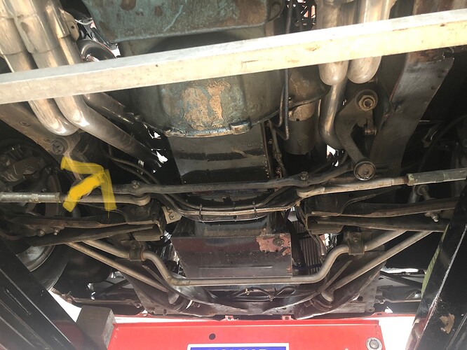

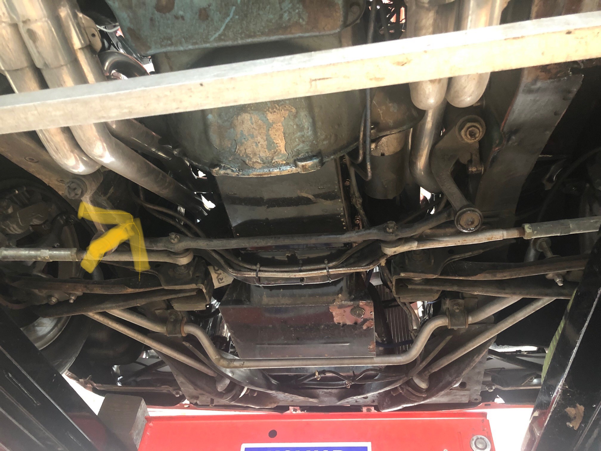

The power steer line will be re-routed around the front of the motor to get the tubes far away from the left side headers . This will help getting PSfluid temps down… in the photo below, you can see the lines hugging the pipes then looping under the sump.
When you re-route the p/s lines, add a p/s cooler from an XG/XH Falcon. Position below the radiator in the front pan opening.
Thanks Leon
I really wanted to make a run (Friday), we ran out of time… and routed some long PS hoses around the front of the engine, away from the headers.

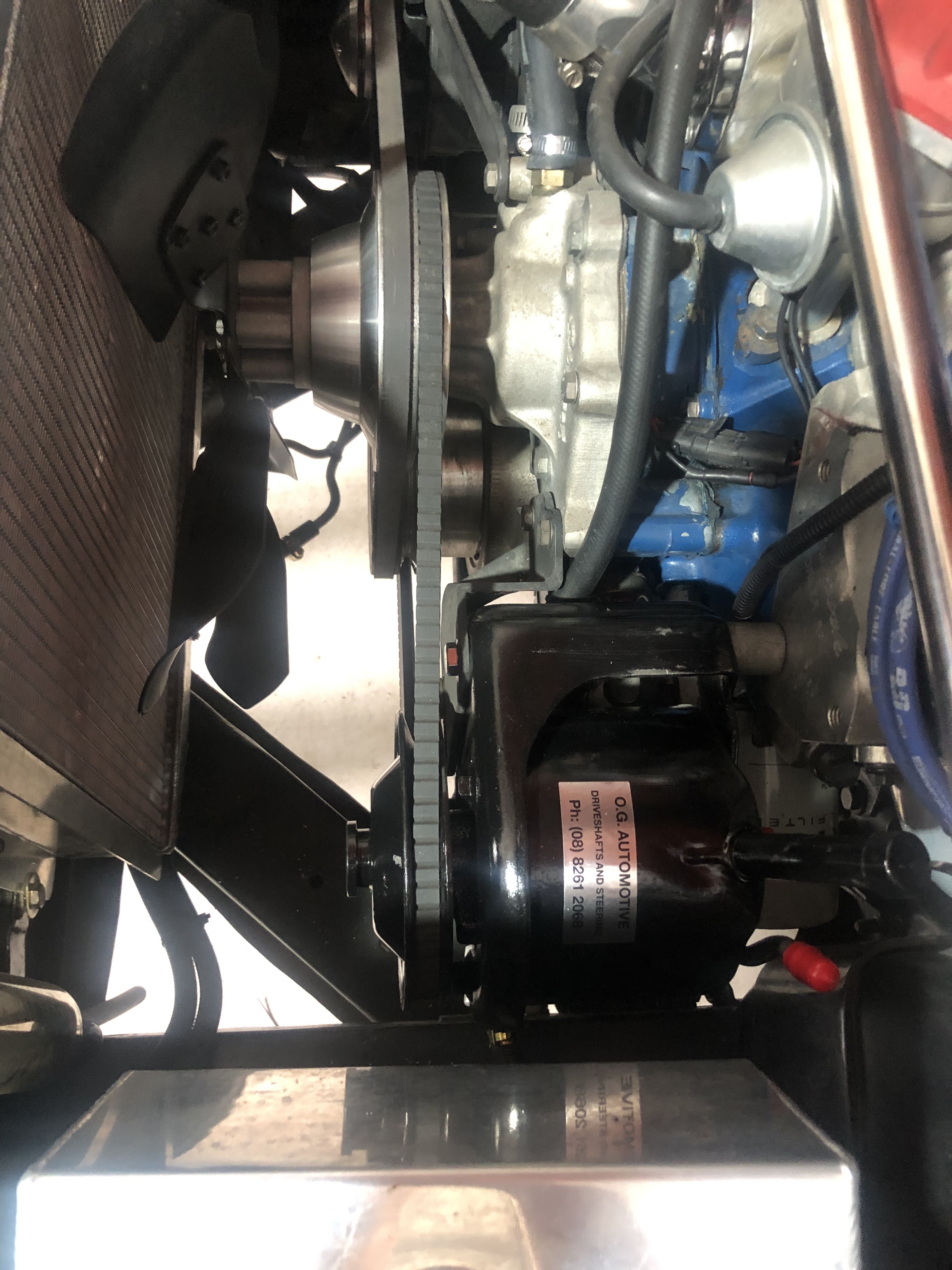

Refurbed pump. First fit, it got aligned…
The pitman arm was replaced as it had some slop. As was the Rag joint. The opportunity was taken whilst everything was out. Now there is zero slop. The steering wheel is now exactly half a spline out dead straight. It clocks a touch left or a touch right… driving me spare…first world problems….

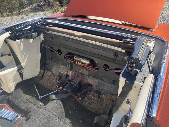

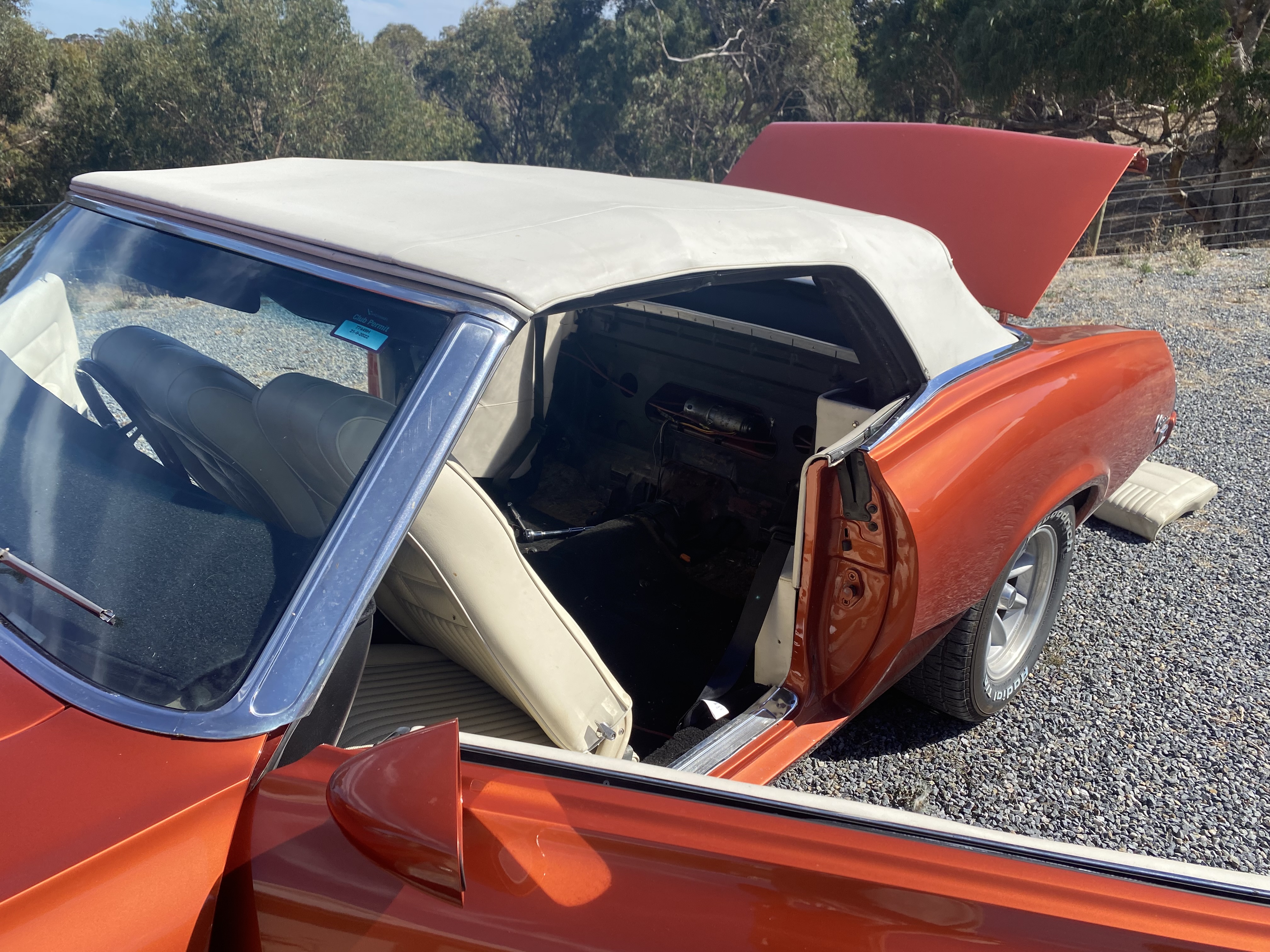

So I have been driving the old girl around occasionally this summer, and the roof stopped opening…
It would close no problem (the motor would drive against end of travel), just would not open. In the blazing Aussie sun, all four down and rear window zipped out is how I drive anyway.
I wanted to do an end of season twilight cruise… enough is enough
No obvious fuses… must be the switch… as I had read that is a typical culprit .
Without power it felt and sounded like poles were thrown. I opened up enough access to test continuity and it seemed fine.
My RHD conversion has a blade fuse box, they were all good…I then started trying to trace wires looking for in line fuses. Found none.
So I ripped out the seats to investigate the back… only two wires here with one connector … figured polarity drove motor one way or other… so electrons should flow either way?
Disconnected and reconnected the connector and it just worked…. Huh?
Kids come out congratulating me, I fixed it…. Wish I knew what I did to make it work.
