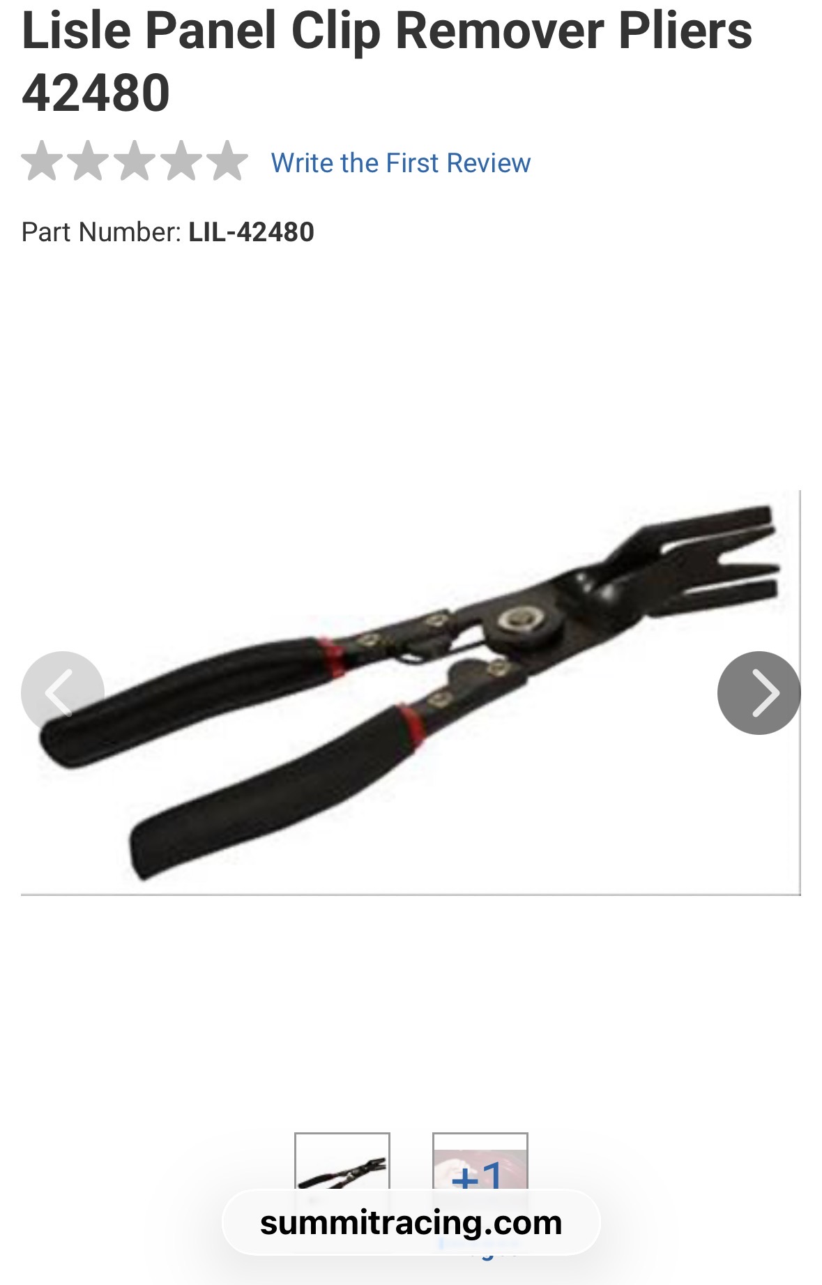

Eastwood has this:
There are multiple variations of this tool. You can get one off the various tool trucks, Snap-On, Mac, Matco, etc. They used to be available through the Help section in many auto parts stores, I have seen them at Harbor Freight. I have one that has a spring loaded squeeze handle. This style seems to put less pressure on the door panel backer board.
Who makes and model number of the one you have that is spring loaded? I just don’t want to put any stress the backer board. Some work better than others but just wanted to make sure I get the best one. I just ordered a new latch. Thank You
The spring loaded one that I have works on the same principle as the Lisle one pictured above. Mine is a bit different though. I will have to take a look at it later today to see if there are any markings on it as to the manufacturer and/or part number.

The one that I have is a Blue Point, a brand sold by Snap-On. It is model #YA331.
Thank You.
This is the one I have. Used it for years. I believe they supplied Snap on, Mac, etc….
The one that 70scj4spvert posted a link to looks exactly like my Blue Point tool.
