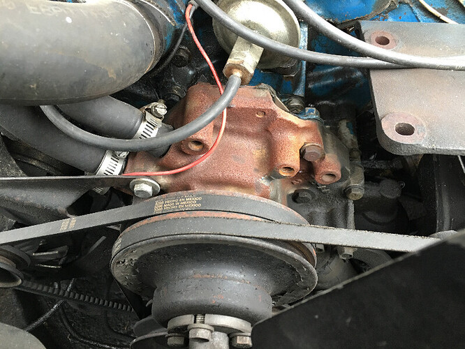

#3, There are a bunch of different pumps that I can buy. Would you purchage the “heavy duty” one? Did you all paint it Ford Blue before installing it?

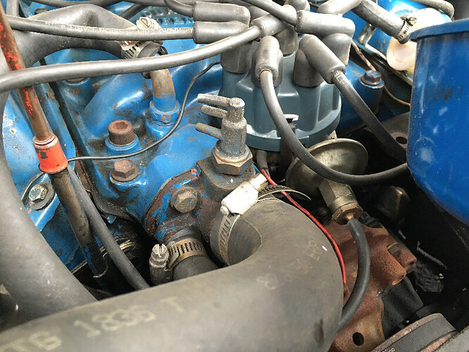

Also, is something on top of the thermostat housing that looks like should be hooked up, not sure (pictures attached).
Also, the hose from the passenger side of the water pump goes up to the engine at a very acute angle. From photos of restored engines, it appears this hose is supposed to go up to the firewall. Is this the heater hose? Why would someone bypass this?
That is the Distributor Vacuum Control Valve. There is a nice write up 72HCODE on the 7173 Mustangs Forum describing it’s function here: http://www.7173mustangs.com/thread-under-the-hood-mysteries-distributor-vaccum-control-valve
Or, for the link challenged :wink: :
Under the hood mysteries: Distributor Vaccum Control Valve.
What is it? what does it do? is it an emissions control device?
This is what a Distributor Vacuum Control Valve or Ported Vacuum Switch looks like
[Image: vacuumswitch.jpg]
This little device may not appear to be all that important in fact most people believe it to be a direct part of the evil emissions system, but it has a big job to do when your engine gets too hot. The threaded end looks a bit like an engine temperature sensor or a thermostat, and that’s because it is.
It’s normally mounted on the intake manifold or engine block where it can sense coolant temperature. On the 351 Cleveland or 302 there is a port for it right on the water pump housing around the alternator.
[Image: 0900c15280053c99.jpg]
The three ports at the other end are for vacuum connections. One goes to full manifold vacuum, another to carburetor vacuum or ported vacuum, and the third goes to the vacuum advance on the distributor.
[Image: dist-vac-valve-6.jpg]
At normal engine temperatures, the distributor gets ported vacuum, which is 0 psi at idle. During extended idling on a hot day in bumper to bumper traffic, the engine temperature can start to rise pretty fast, especially with air conditioning on. That’s when this little device goes to work.
When engine temperatures reach about 225 degrees, this switch changes the distributor vacuum advance source from ported to full manifold vacuum, which is high at idle. This advances the timing and engine rpm increases.
The result is increased radiator fan speed and coolant flow through the engine and radiator, which tends to bring the temperature down.
Once the sensor determines the coolant temperatures have dropped to a safe level, it reverts back to ported vacuum and the engine timing returns to normal, returning the idle rpm to its normal setting.
Chances are most people have never even noticed when this device is protecting their engine, they just notice that the temperature gauge drops a bit, or the HOT light on the instrument panel extinguishes.
This Valve is a compensation to the emission system. It addresses a problem that can occur with lower timing at idle and engine overheating. since all 71-73 cars were designed to use ported manifold vacuum as an emissions reduction at idle if you have an A/C car with heavy load on accessories and you want to maintain stock functions of the engine, its a good idea to restore this valve if it is missing from your vehicle.
Personally i think its pretty trick having the ability to change the type of vacuum the distributor sees at idle based on Engine temperature, even if the trade off is reduced idle emissions, and emissions control is evil.
now at a car show when somebody points to one of these valve and doesn’t know what it is or takes out a cross and shoots garlic at it, you can tell them what you learned here Smile.

Given that your water pump is unpainted, it was probably replaced in the past. I would hold off on that until you have proof that it has problems.
If there is no flow through the radiator (leave cap off and let it idle, you should see flow after car comes up to temp and the thermostat opens), or it shows signs of leaking, then it probably needs replacing. Or if you remove the belts and spin it by hand and the bearings feel “rough”.
If you are having overheating issues (which you may not know until you get it more road worthy), it could be the pump or the fan clutch, or thermostat, or radiator, or timing, or… the list goes on. Deal with that once you find you actually have a problem.
Thermostat → as I mentioned above, leave the radiator cap off and make sure it is opening when the car starts to come up to temp. Look for the flow in the radiator. You can buy a cheap thermometer to set in the radiator and check the coolant temperature when the thermostat opens. That will tell you what temp thermostat is in there, as well as give you a ball park of what the temp is if you compare to your temp guage.
Hoses → yeah, replace them. Coolant, yeah, replace that too. Cheap insurance and easy to do.
The hose that loops back to the water pump IS your heater hose. If it is bypassed like that, chances are the heater core is leaking :frowning:

Distributor Vacuum Control Valve has been explained. What else you may need is the vacuum hose kit to replace the missing lines.
Here is an example: Marti Auto Works - DVK-9 - DISTRIBUTOR VACUUM LINE KIT
Or, you can go to the parts store and buy some vacuum lines and do it up yourself. It should be similar to this…

  6. What concerned me about the water pump is that it is completely rusted on the outside, so I figured it must be very old. Not leaking, and like you said, not sure about overheating issues until I drive it a bit. The radiator looks ancient as well, so I know that will be on the list soon.
  7. I thought that was the heater hose. That’s what I was afraid of (only reason to bypass it is if it is not working). I will probably tackle that issue when I evaluate the pump/radiator.
