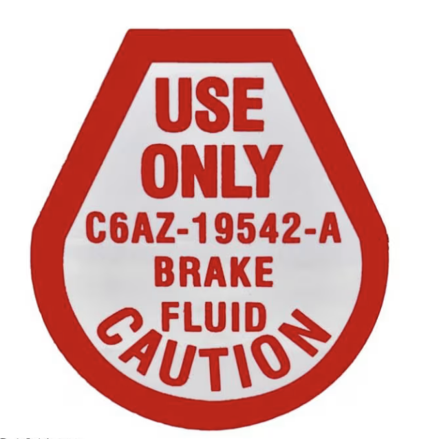

  1. POWER DISC BRAKE MASTER CYLINDER DECAL

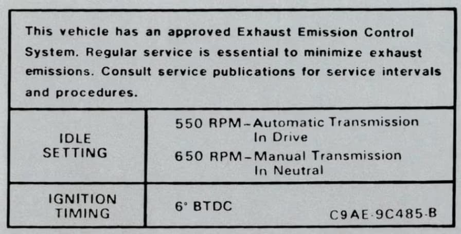

  2. DECAL EMISSION - 351-2V

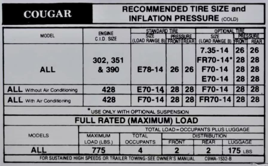

  3. DECAL - TIRE PRESSURE

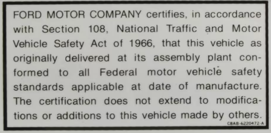

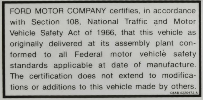

  4. DECAL - SAFETY ACT

  1. On the master cylinder lid after you paint the booster and master cylinder semi gloss black
  2. On the LH valve cover just below the oil filler cap
  3. Inside the LH door jam above the latch
  4. In the center of the deck lid. Underside.
