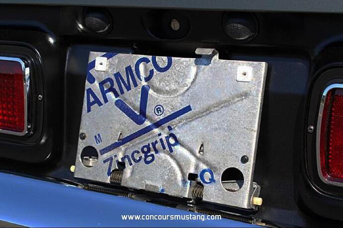

Yes, originally the metal was galvanized since the same part was used on 69 -70 Shelby’s I’ve done a number of them. Items like floor pan plugs, door latches, trunk latches and other parts that make up our cars were finished in the same plating.
To duplicate this finish we first tried to have them plated but could not get the look right. Either they were plated with too much product, chunks and shapes were not right - looking much more towards heating and A/C duct finish found on home HVAC at the furnace look. Originally they were plated on big sheets with the logo of the company that proved them to Ford and other companies and the parts (license plate and hinge brackets) were formed from these sheets exposing the logo on some finished parts. We reproduced stencils for that reason.

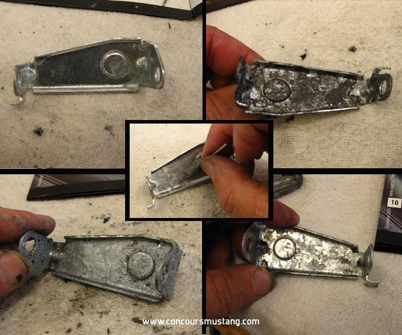

After multiple attempts at plating the best results came from plating the metal in zinc then doing a faux finish using multiple applications and removal, using a stiff plastic bag technique to produce the geometric shapes we were looking for. Then coloring the mounting studs, reassembling and installing
Here is a link to a thread on the effort
If your a member there (ConcoursMustang.com) there is a full article in the Library section in the Shelby section titled Reproducing Galvanized Finishes with more details and pictures.
Thread - Reproducing Galvanzied finishes
An example of the finished effort - Slightly different methods produce different size of chunks and patterns.
Basic steps and process. Final look is not finished if someone was wondering
