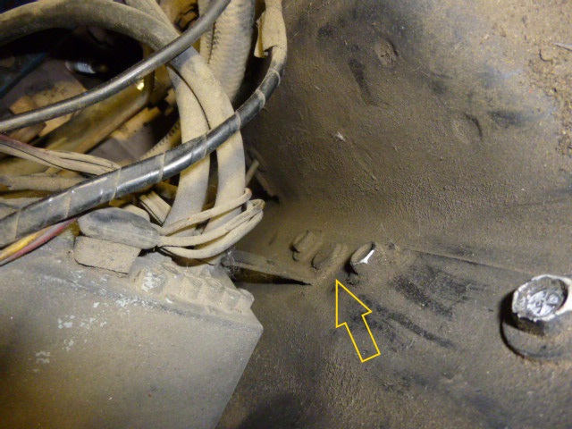

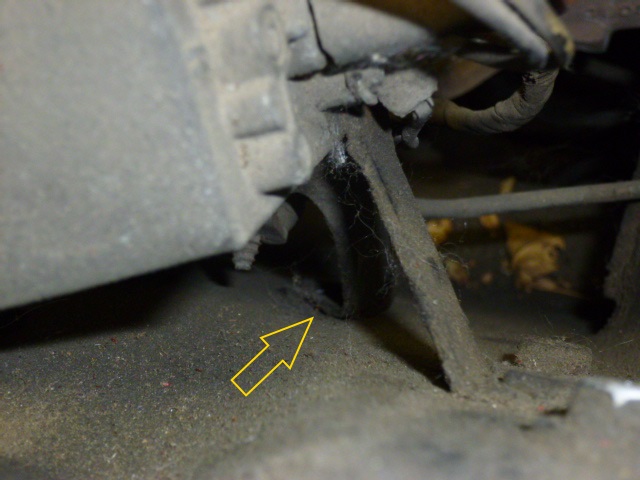

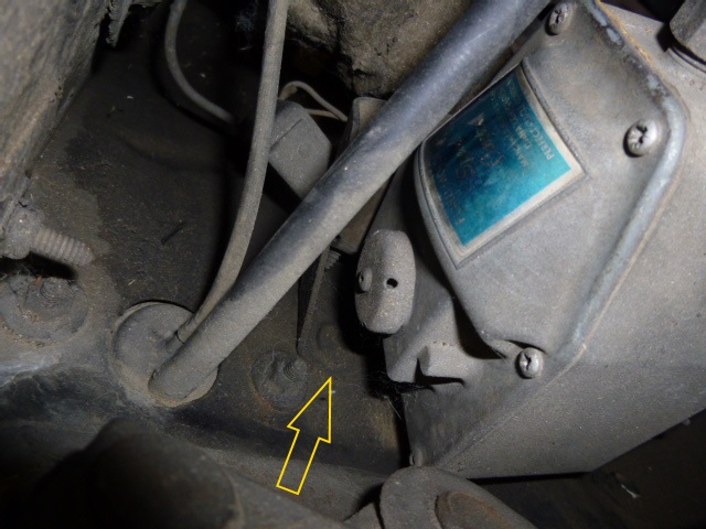

Hi Mark,
Here is a couple of pictures of my 69 convertible w/factory speed control. Its hard to see, but it is a 3 point mounting for the speed control.
Hope this helps.
Great pictures. Just what I needed. Thanks a million!
