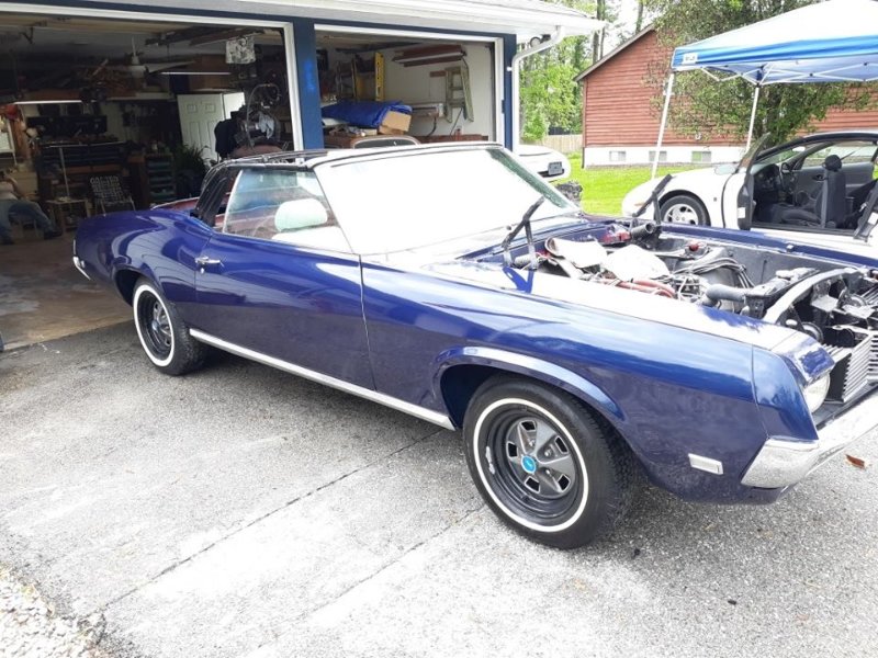

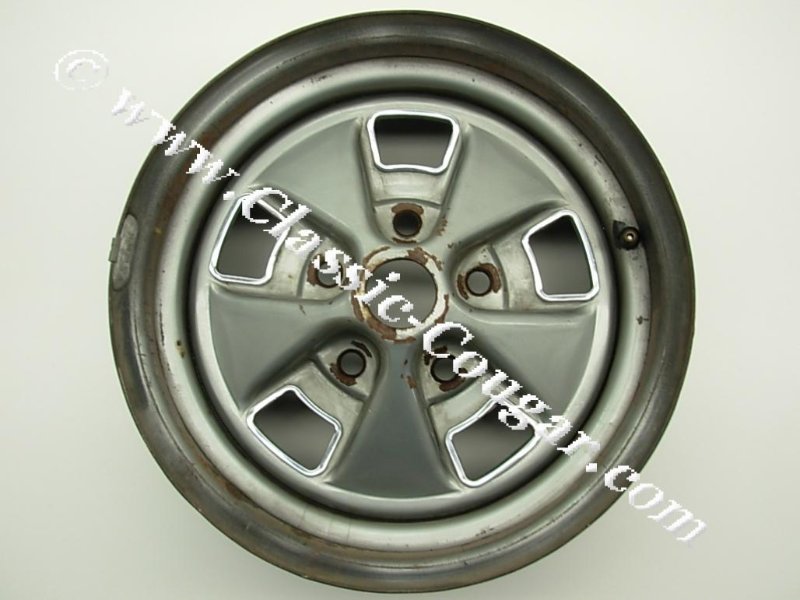

Was the entire front of the rim painted Argent like the WCCC picture. Or just the center portion like the blue convertible??
The front side of the 5-spoke center section of the SS Wheel was painted the Dark Argent color. The inner mounting side of the center section and inner & outer areas of the wheel band was painted Black.
