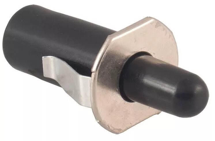

I have a new door switch
I would test it with a meter.
I think its more like the wrong switch. The one that someone installed before I purchased the car is the shorter nipple type like used on earlier cars. I ordered the one with the longer rounded nipple. like shown, should have it by Saturday.
