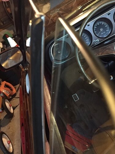

I have a fairly large gap between my front and rear windows on both my passenger and drivers side doors at the roof line.
I was able to get the gap down to about a 1/4 on an inch on the passenger side (I’d prefer no gap but It’s better then it was), but the driver side is not cooperating as well.
On the drivers side the gap is 3/4" or more at the roof line and the front window adjustment is all the way to one side. It would need to move farther to lessen the gap. My question is “Are the rear windows adjustable”? If they were that would seem to be the next place to work. I loosened the 4 bolts in that are in the door jam but that didn’t seem to allow for any movement on the rear window.
Any or all suggestions would be appreciate. I’ve included a photo of the gap to show you what I’m talking about if it is not clear.
Thx,
Jay

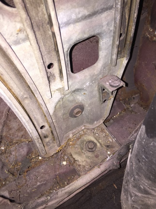

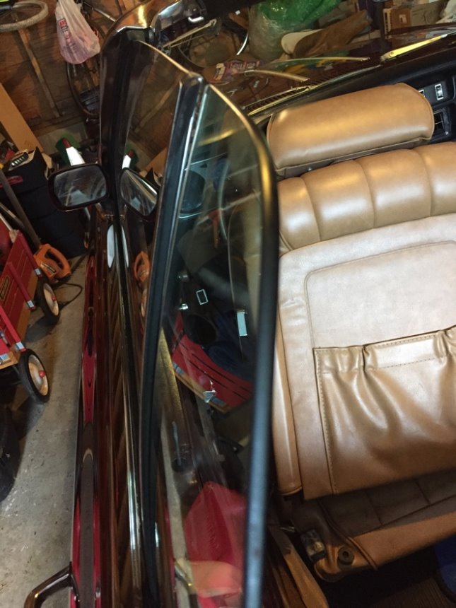

Took out the back seat and removed the rear quarter panel (if that’s what you call them) and the rear window adjustment was all the way to the one side. Moved it to the other end of the adjustment and now it is MUCH better!
I included a picture of the adjustment bolt and the better aligned driver side window.
At this point I think the only thing to do to make this any better is to replace the rubber on the windows and that’s too big of an effort IMHO.
I can live with this gap.

I installed the new door glass to quarter window seals, it helped a little bit on the passenger side but not the drivers side.
To get it any better I’ll have to elongate the adjustment slots on the front and rear windows and that will be a lot of effort to remove and rework.
Maybe I can do it “in place”, I think for this season I’m done (got to have something to work on next year).
Like I said before, it is much better then it was, it’s just not perfect (meaning rain would get in a little if caught in a rain storm).
