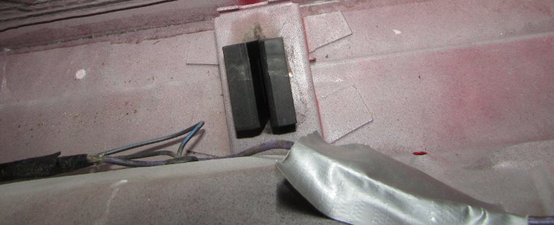

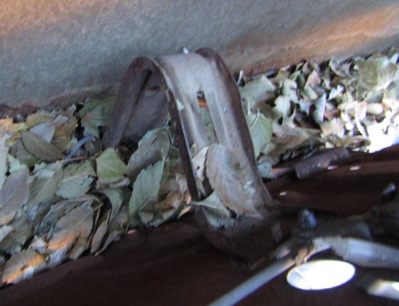

Don’t see anything in the center. Reinforced channel? Only thing that bolts at the bottom are window guides. The window rides up and down the two rods. One toward the front of the door and one toward the back. I’ll try to get some pics.
At this point I should probably look into removing the glass. How is the best way to do that?
The bracket is part of the door after everything has been removed.
See pic
another door
Top door is a 70 & the bottom one is a 68.
Hope this helps!
