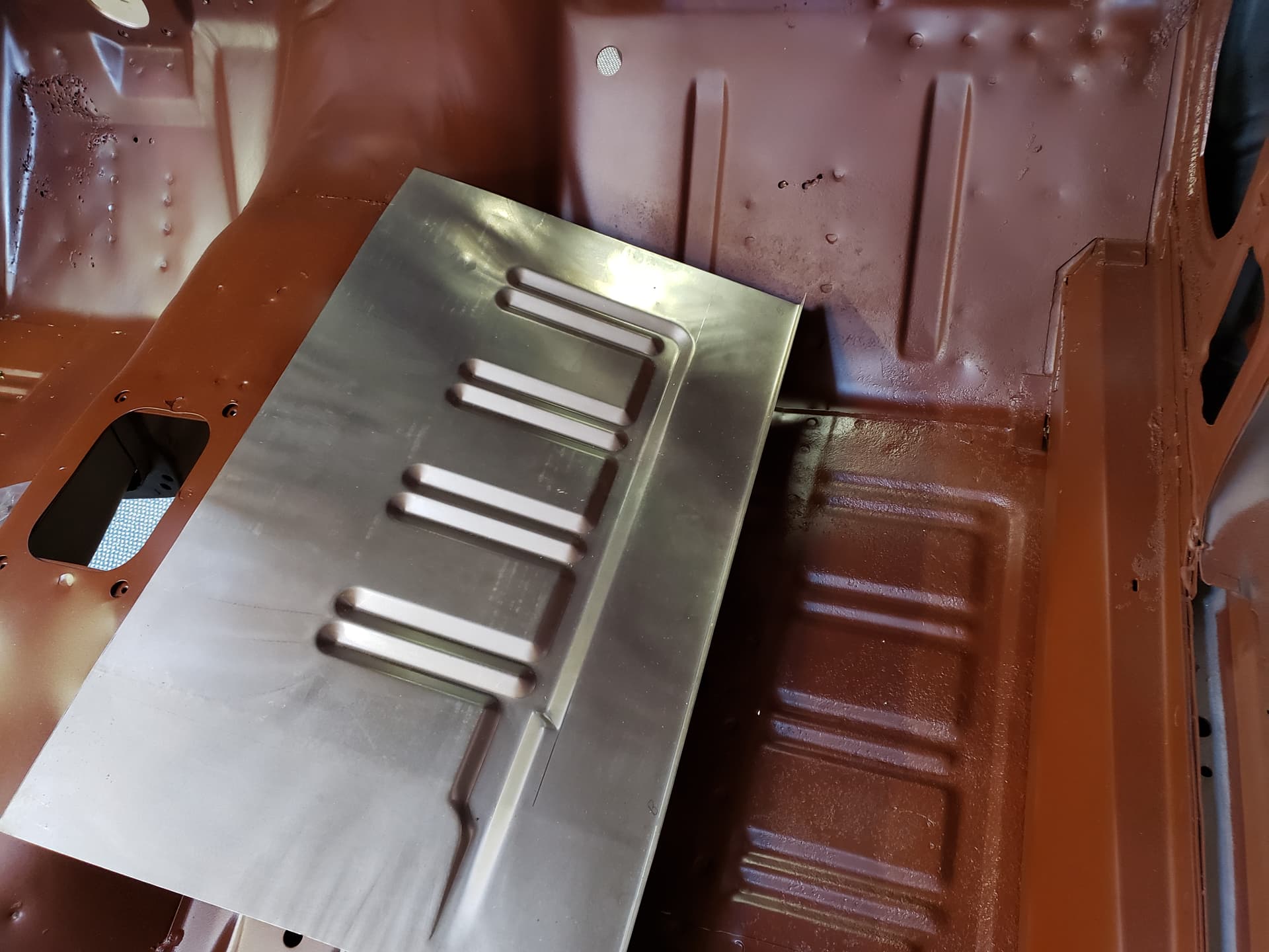

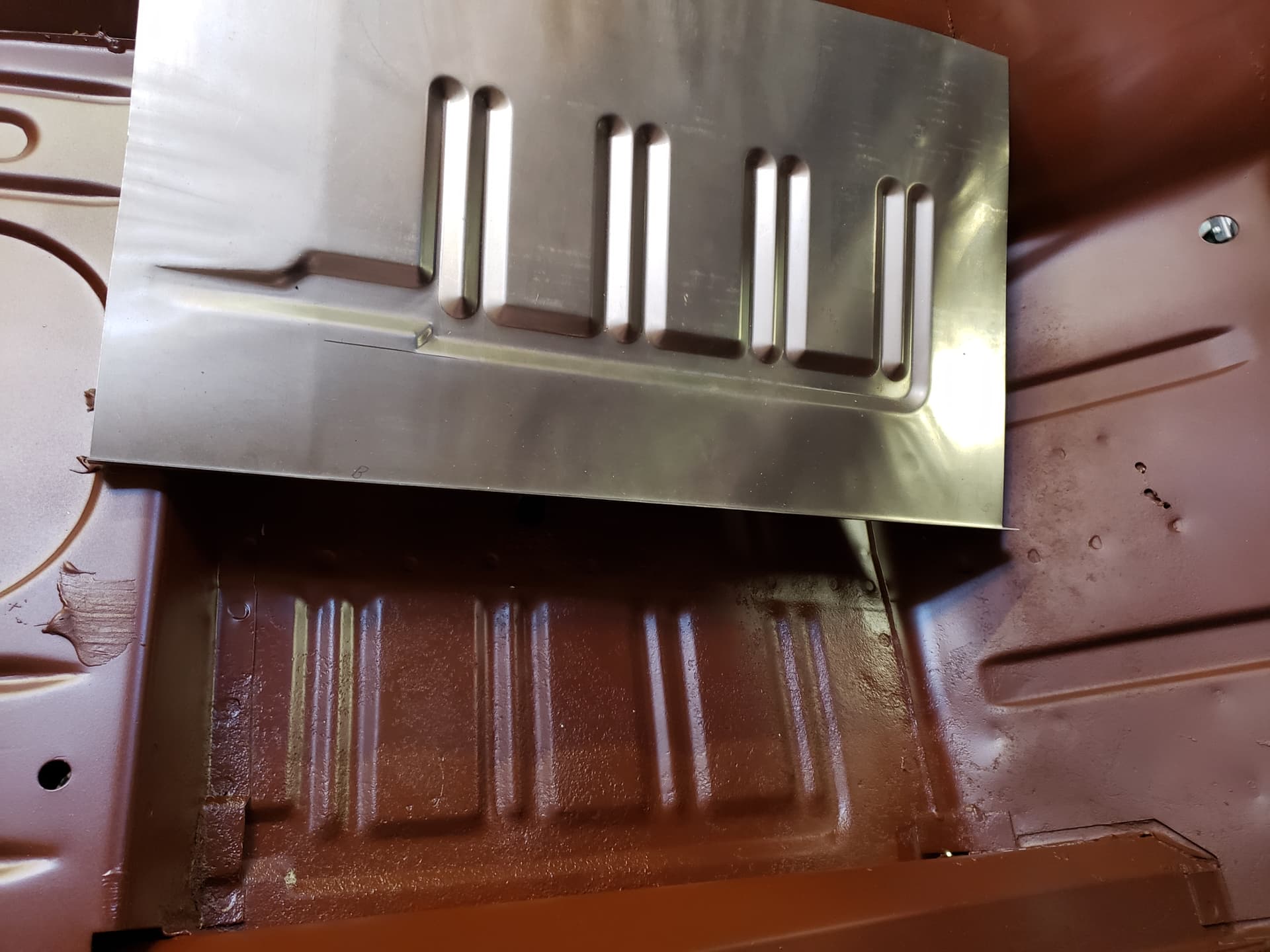

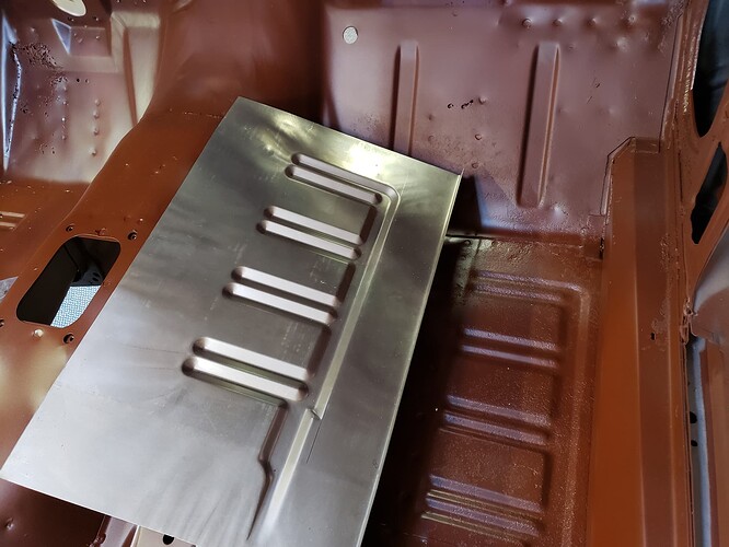

what’s the best replacement f/pan avail - i see WCC is selling a convert pan with no front drain is it from a 1971-1973 mustang
The floor pan is special. Boss 429 supposed to share the same.
They are made by/for a towing company back east. Ill have to dig thru things this evening, unless someone else has this info. Cost was $225? Very nice piece
Are you looking at a full pan? Half pans, or the patch panels Bill showed.(I used one of those to fix Gingers floor a number of years back.
full length but just the right side
I’m not aware of anybody making perfect replacement pans. But this should be a good product.
I bought a set for my CJ Cougar, but decided to go with a full pan. But, even though I have a right hand pan here, it’s for a hard top.
Good luck with your project.
missed out on a 70 cj XR7 - triple black – yes I’ve been eyeing this pan from WCCC - it looks the same as ones described for a 71-73 in all the mustang parts sites- because of the no front drain hole - i asked Ken @ ken’s cougars but he said don’t use a 71-73 pan - tough to get through to anybody at WCCC
