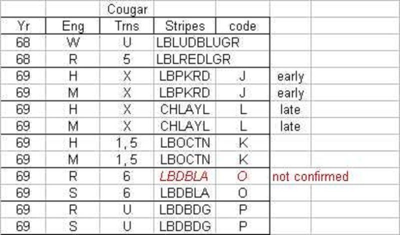

Master Parts Catalog shows transmission code "X behind either “H” or “M” code engine has stripes “CHLAYL” code L. I don’t know what the first stripe would be - CH is the abbreviation - followed by Light Aqua and Yellow with an “L” painted on the shaft as further identification.
No reason for a different shaft for Cleveland or Windsor.

So where about are these colors mentioned in the MPC?
I see NO reference to them anywhere.
I did study my master parts catalog before I asked here, and I could not find any color codes there either. Anyway, the information you guys came up with is very good and extremely helpful. Maybe we should make a knowledge database with all the paint marks here on this forum? I am sure that would have been extremely helpful for those doing concourse restorations or even for those who like to do their best (like me) :slight_smile:
Pretty sure I got this from the MPC? Mine is not the 1975 Final revision, it is an April 1969 version so it goes no further than 1969. There are some obvious omissions, for example 1968 the “S” code, “W” code and “R” code all share the same drive shaft.
