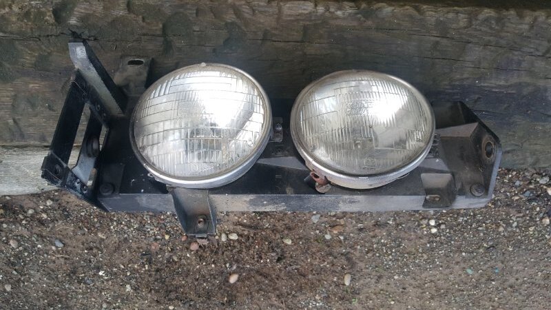

I’m looking for a source to find some bumpers for my replacement headlight housing. They are the bumpers in the upper L/R corners. See the attach picture. NPD doesn’t have them and WCCC said they don’t have a solution for that part yet. Mine were so brittle that they snapped in two pieces when I tried to remove them. Thanks

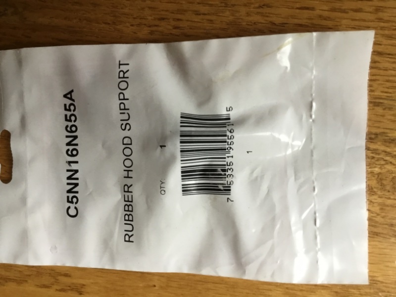

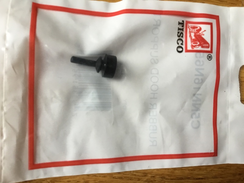

These worked perfectly for me. Sold for Ford tractors and you can find them on Amazon.
$35 each with shipping? OUCH!
Looks like I actually paid $10 for 10 on eBay. But I did send the info to Darrell in hopes WCCC might be able to source and sell them.
Huh, I saw them at $2.99 each plus shipping by inputting that part number on Amazon

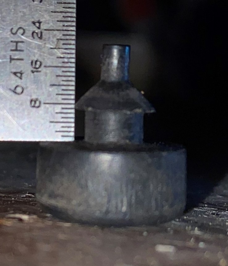

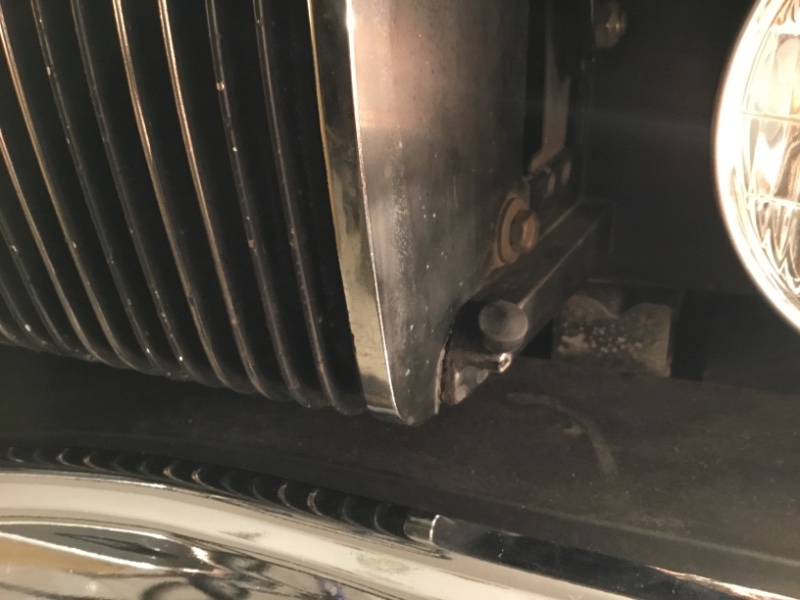

The head does measure 1/4” high and 1/2” diameter with a slight bevel on the face. The shoulder that fits in the hole is 0.2” diameter, and the flange that holds it in measures 3/8” diameter. It fits a 3/16” to 1/4” diameter hole, but is just a bit snug in the headlight bucket hole. It took some silicone grease to get it through. I also installed these in the stop at the bottom of the center grille to eliminate the bang and rattle when headlight doors are closed.

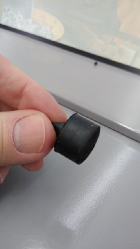

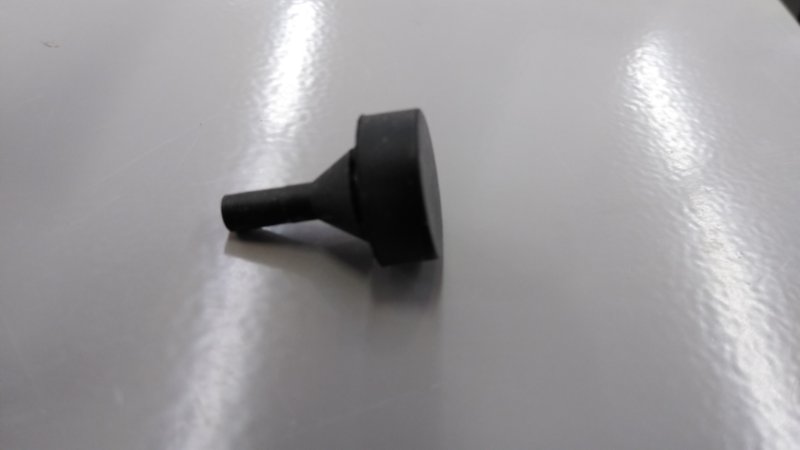

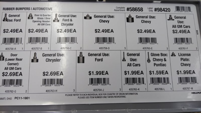

Take a look at these pics and see if any might be a good match. These are the off-the-shelf bumpers at the local hardware store.

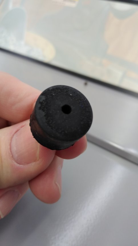

The one with the hole in the center looks good. What is the size?
Yes, if the one with the hole in the top is 1/2” dia, 1/4” tall, and fits a 3/16” hole, I like it better than the Tisco ones I found.
Here’s what I found online for that fastener box
https://www.hillmangroup.com/us/en/Fastening-Solutions/Specialty/Automotive/Bumpers---Auto/Automotive-Rubber-Bumpers-Assortment/p/541BP1#specs
I just looked at my 1970 and the one with the hole in it does not match our cars. None of the other bumpers had a hole in them.
But the one in my pics labeled “IMG_20201024_120738635.jpg” is a close match…

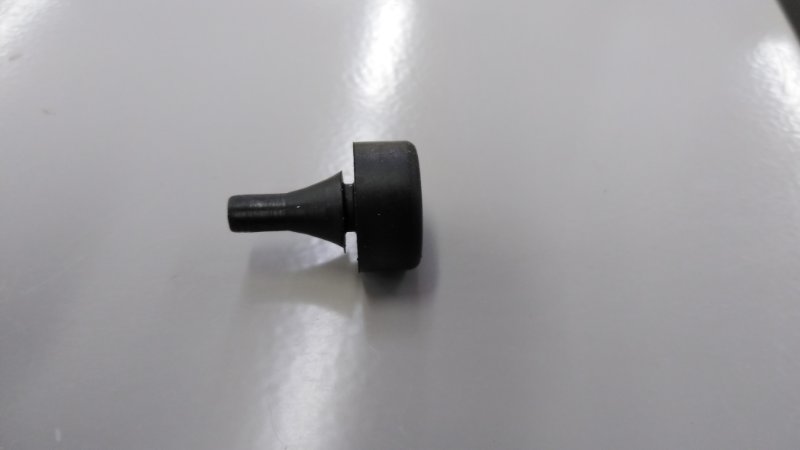

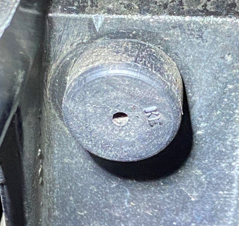

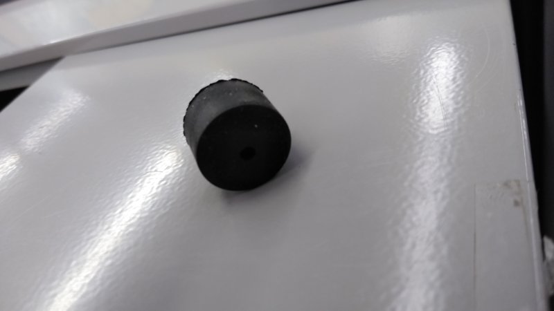

Pulled out one of my bumpers and took some pics and measurements.
Hole in the headlight framework is 3/16"
Bumper face is 1/2" diameter and 1/4" thick. Mine are all marked “KE” and have a 1/16" hole in the center of the face.
Shaft of the bumper is about 1/4" long before the flange.
