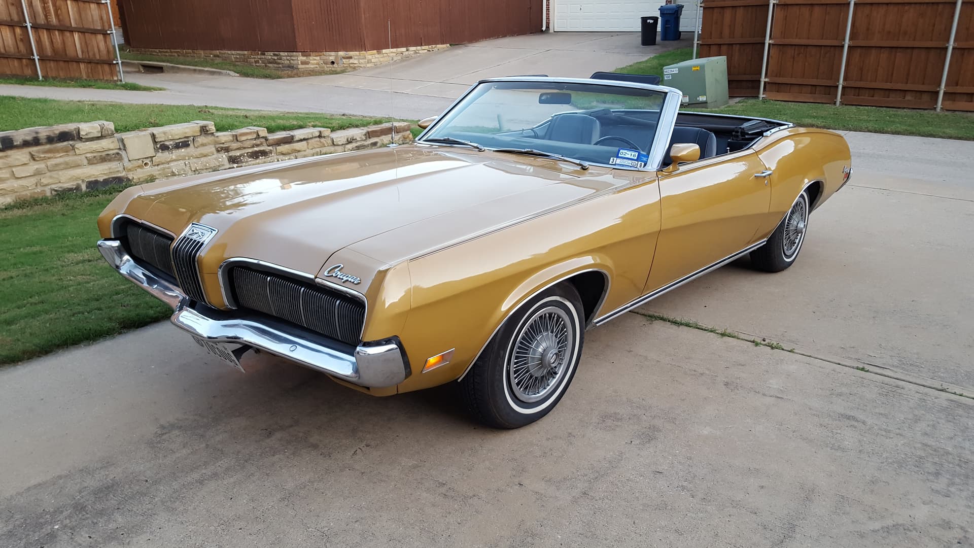

At a dead end troubleshooting my ‘70 convertible heater issue. A/C works fine, evaporator and heater core replaced in 2007, Replaced heater valve, vacuum works. COLD-WARM cable works. Disconnected to manually move blend door and hear it moving. Heater hoses to and from the core are hot. Blower still blows cold air at full WARM. I was going to remove both heater hoses to the core and flush it, but with inlet and outlet hoses both hot from the water p[ump and back not sure that’s worth it. Engine temp gauge is in the normal zone so thermostat must be good. Would love NOT to have to remove the heater/A/C box again. Tough job for me. Any ideas are welcome.
