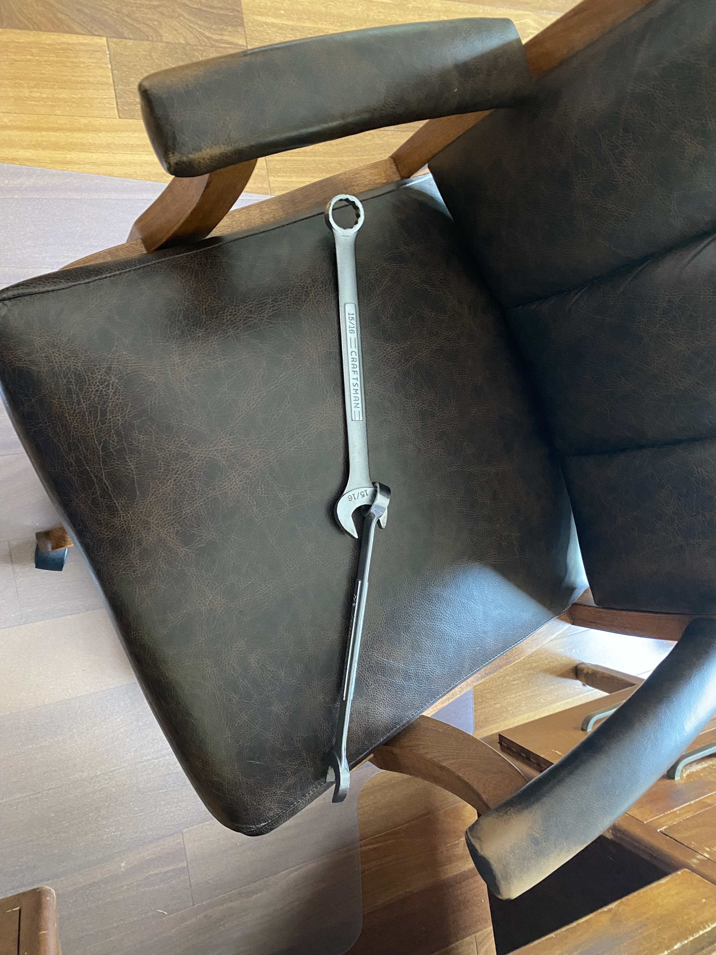

How about standard box end wrench, with another box end wrench to use as a cheater bar for leverage.
I thought about that one, how do I set that up? Using another box wrench as a cheater bar
