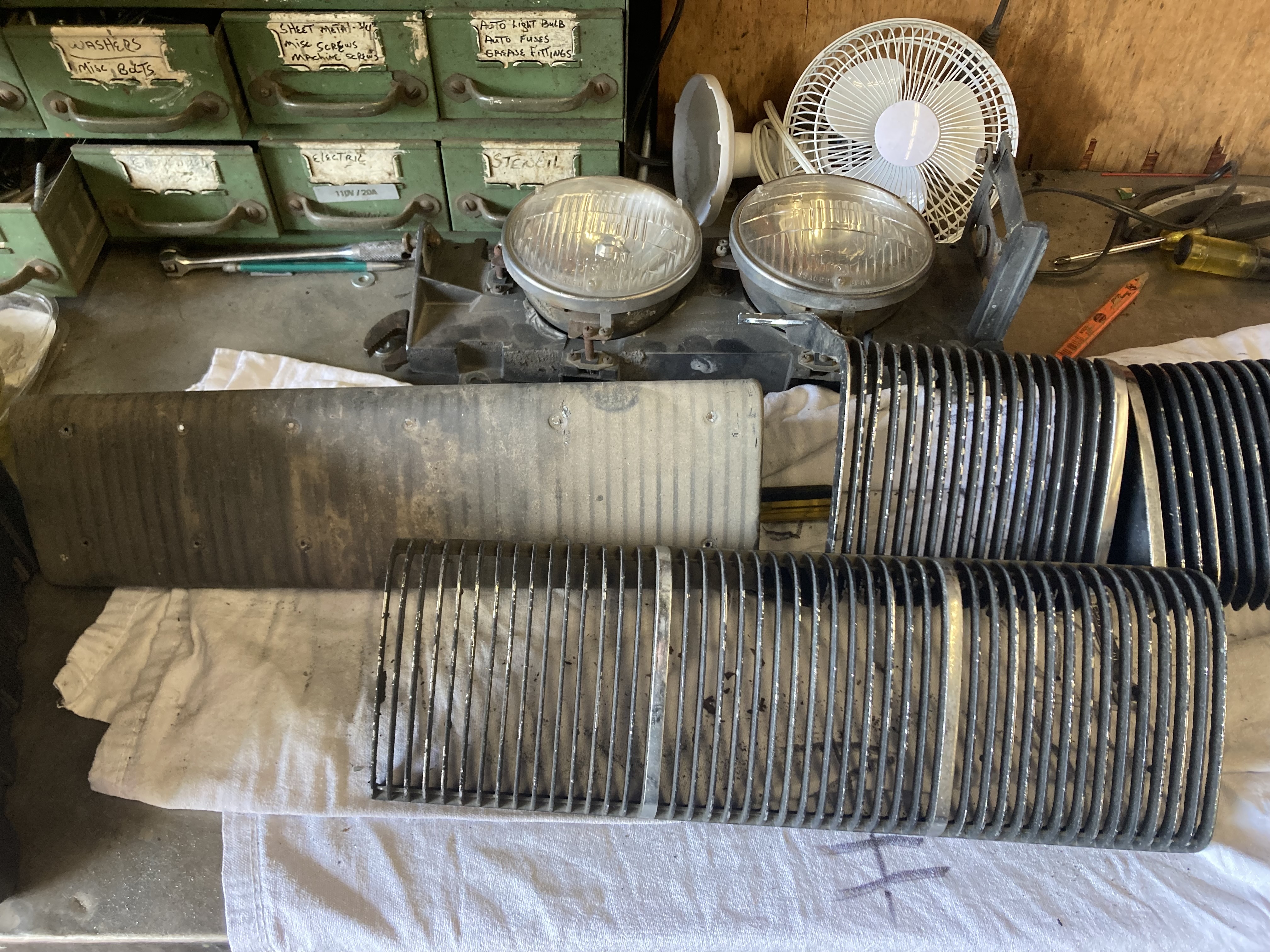

1970 Headlight Door Grille (Trim Black Painting)
I got my grilles re-chromed thru WCCC. Now I’m painting them with Sem Trim Black Spray paint. The black paint is not holding up. Flaking Off. I degreased the chrome but didn’t rough it up. No primer required for this paint. Where did I screw this up at??? I need some help with some good successes out there. Thanks. Gene

I have done several grills over the years 67, 68 & 70 using SEM Trim Black. I washed my parts in Dawn dish soap never used any degreaser. Not one flake of paint has flaked of. Might be the degreaser. I also did not use any primer.

I’m pretty sure if you want paint to stick to chrome you need to lightly sand it first.

Good question. Is the original poster trying to paint over chrome, or is it the bare metal in the gaps? I used paint reducer to super clean the surface between the chromed raised bars and cheap flat black spray held beautifully.
No, Knight, I was more interested in knowing if I should pull the black rectangular pieces off from behind the grill doors or just prep and repaint with them on and just clean and sand well between the chrome grill bars

I wish it was that easy. On the 1970 it appears that there are multiple “studs” on the backside of the grill work. These then go into black sheet metal and then held with a spot weld
