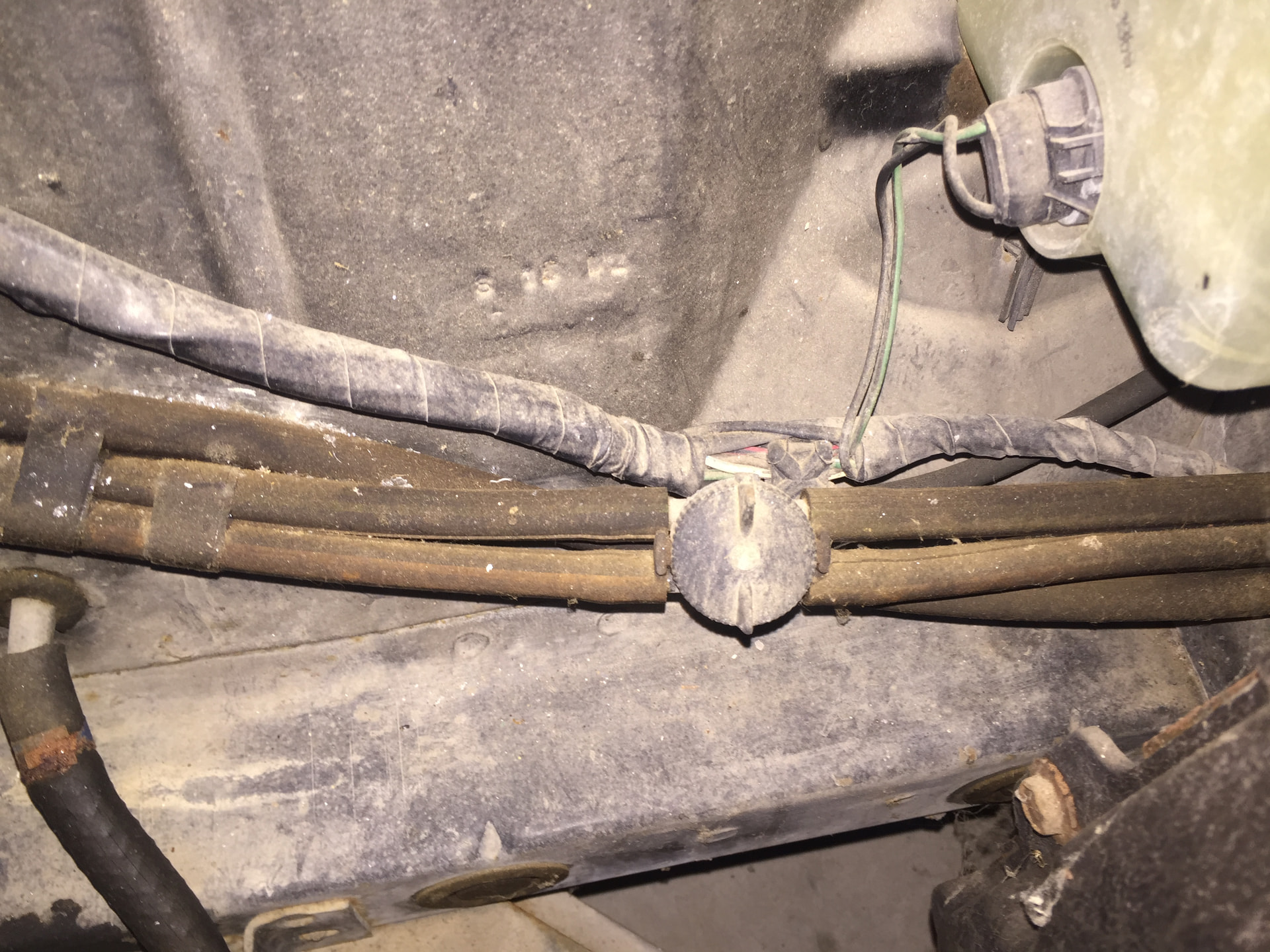

Where is the manual over ride??? Pardon my ignorance
It is a valve in the vacuum hoses located below the windshield washer reservoir. The valve is a typical 90° turn.
