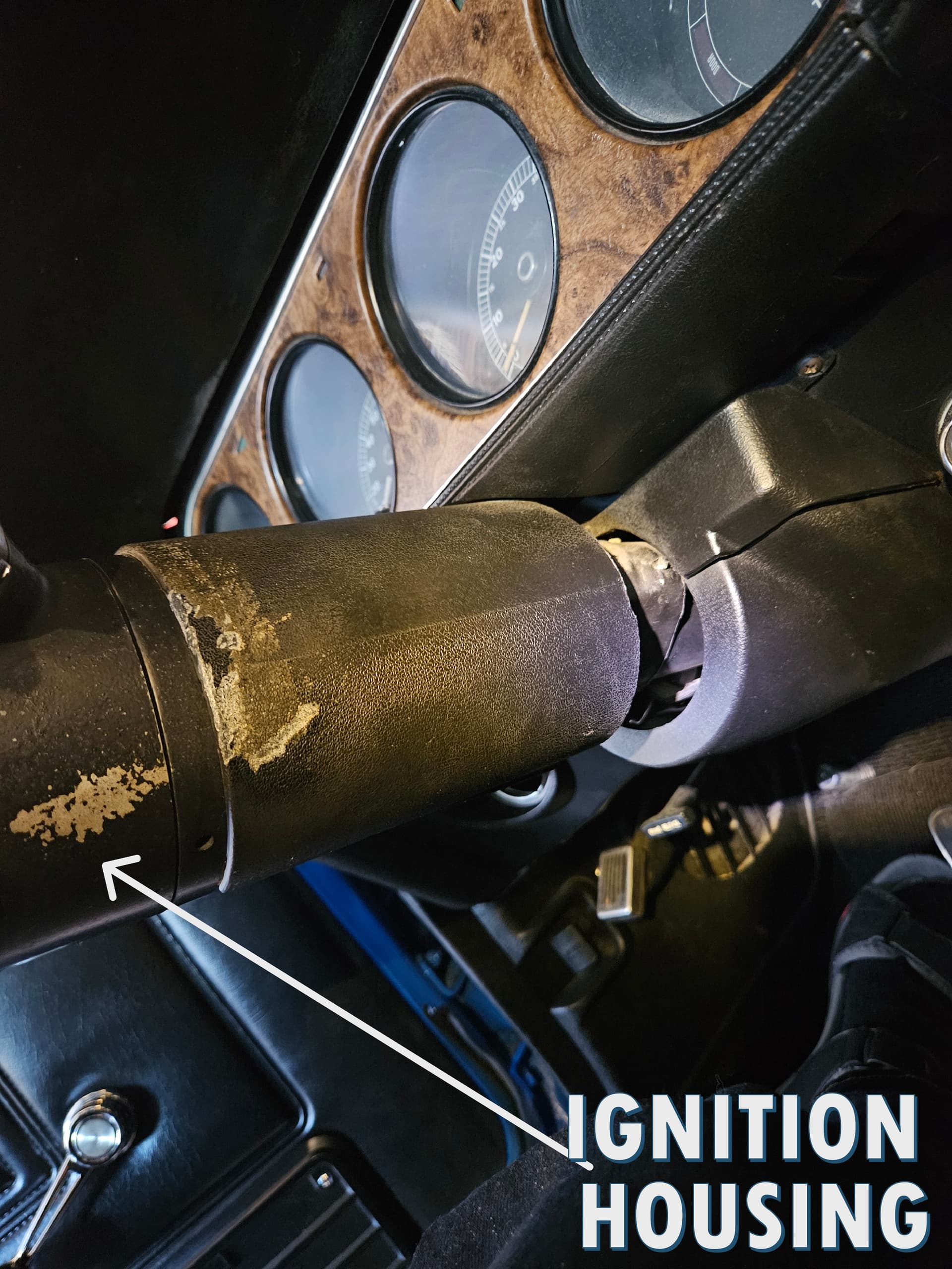

Here is a picture of mine. key usage over the years has taken a tool. Thank you for your knowledge and experience to restoring the color on this housing.
Also, I’m still not sure about the gap you see in this picture. I can’t image that Ford would design it this way. I’m I missing something?

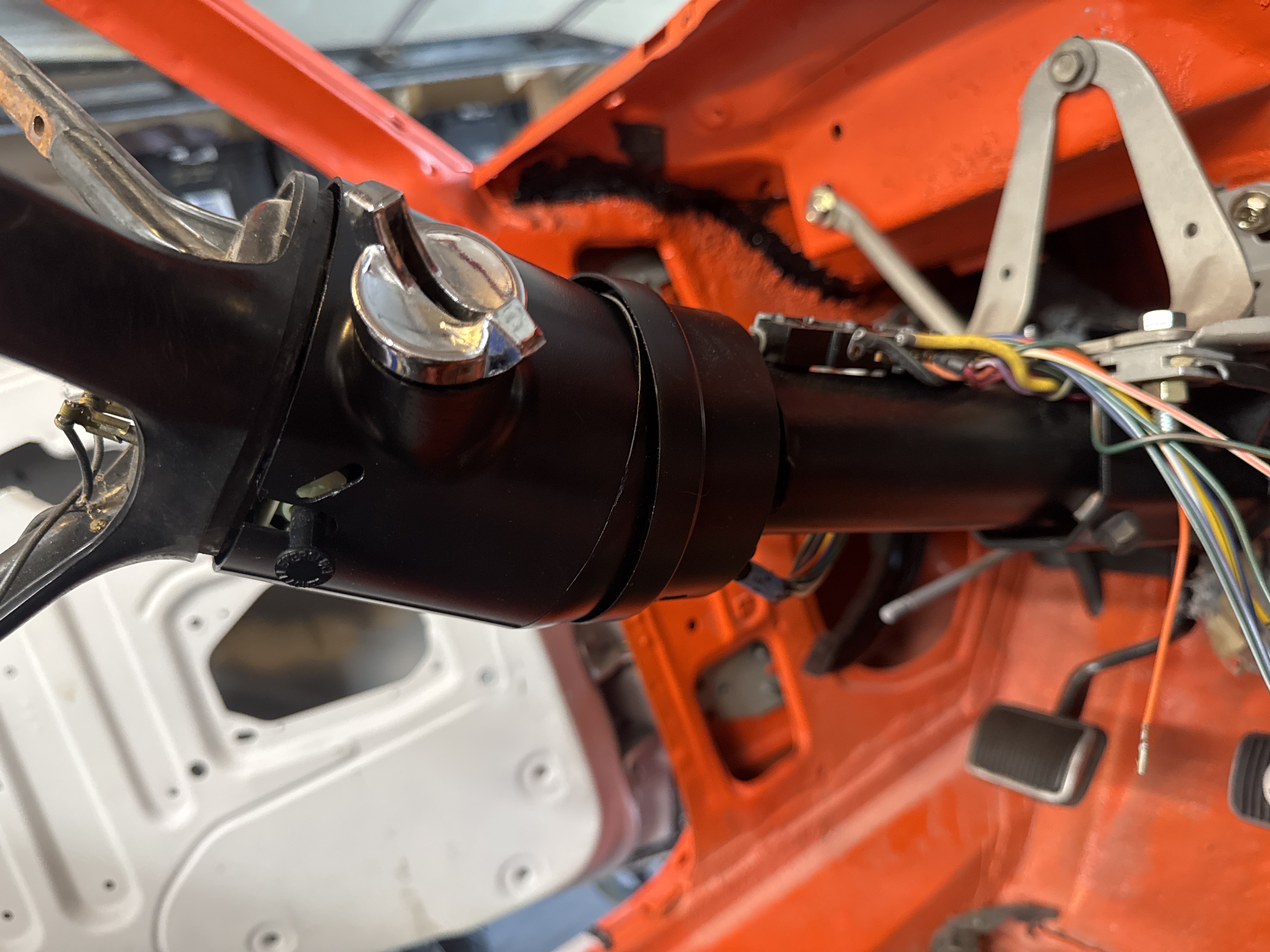

I used a 2k hot rod satin paint from Spraymax. I think the finish is dead on for color and sheen. Amazon.com
Looks great! Thank you for sharing.
Looks like your plastic shroud is slid too far towards the steering wheel onto the ignition switch housing. Should only be about a 3/8” gap at the back. Yikes - mine needs some paint too.
Your picture makes sense. I have some work to do. Thank you for sharing the picture.
Gene
