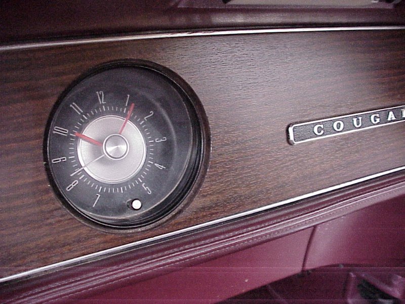

The clock in both a 69 and 70 standard Cougar would have been in the blank section of the instrument cluster, not on the passengers side. If you want it on the passengers side you will have to make a custom wood trim panel. If I were going to do one I would start with a panel from an XR-7 and find a wood grain overlay that matches the Maple wood grain of the original. Or find something I like and do both sides. The rest of the hardware would be XR-7 and not to hard to find.

Thanks, Neal. Much appreciated. I already have the XR& dash panel. There are a few places on the west coast that do "veneers’ or appliqués. I was thinking the same thing of just redoing the wood grain on the passenger side and then the instrument cluster

The best way to do a standard clock relocation, is to take your original standard woodgrain panel (assuming it is in good condition), and then cut a hole in it - same as the XR7 panel. Take your clock from the instrument panel, dis-assemble it. Then get an XR7 clock and mounting bracket and all hardware and wiring. Put the standard clock in the XR7 mount, etc. If done right, everything will look 100% factory. The biggest challenge is cutting the hole in my opinion. WCCC used to offer a service to do that, but does not anymore. The primary purpose for relocating the clock, is it that now you can put a Rocket Man tach in the original spot, and that looks 100% factory as well. I did both of these items on a 1969 Standard convertible I owned several years back, and it came out great. Would recommend this conversion to all!
