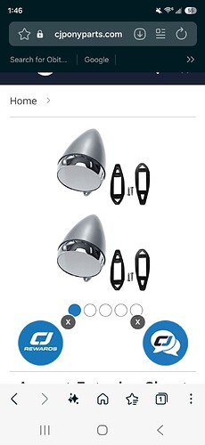

Iâve asked this before on a different thread, but got no answer. So here goes again. Has anyone put 68 bullet type mirrors on a 69??? Always thought those mirrors were cool. Thanks for reading
