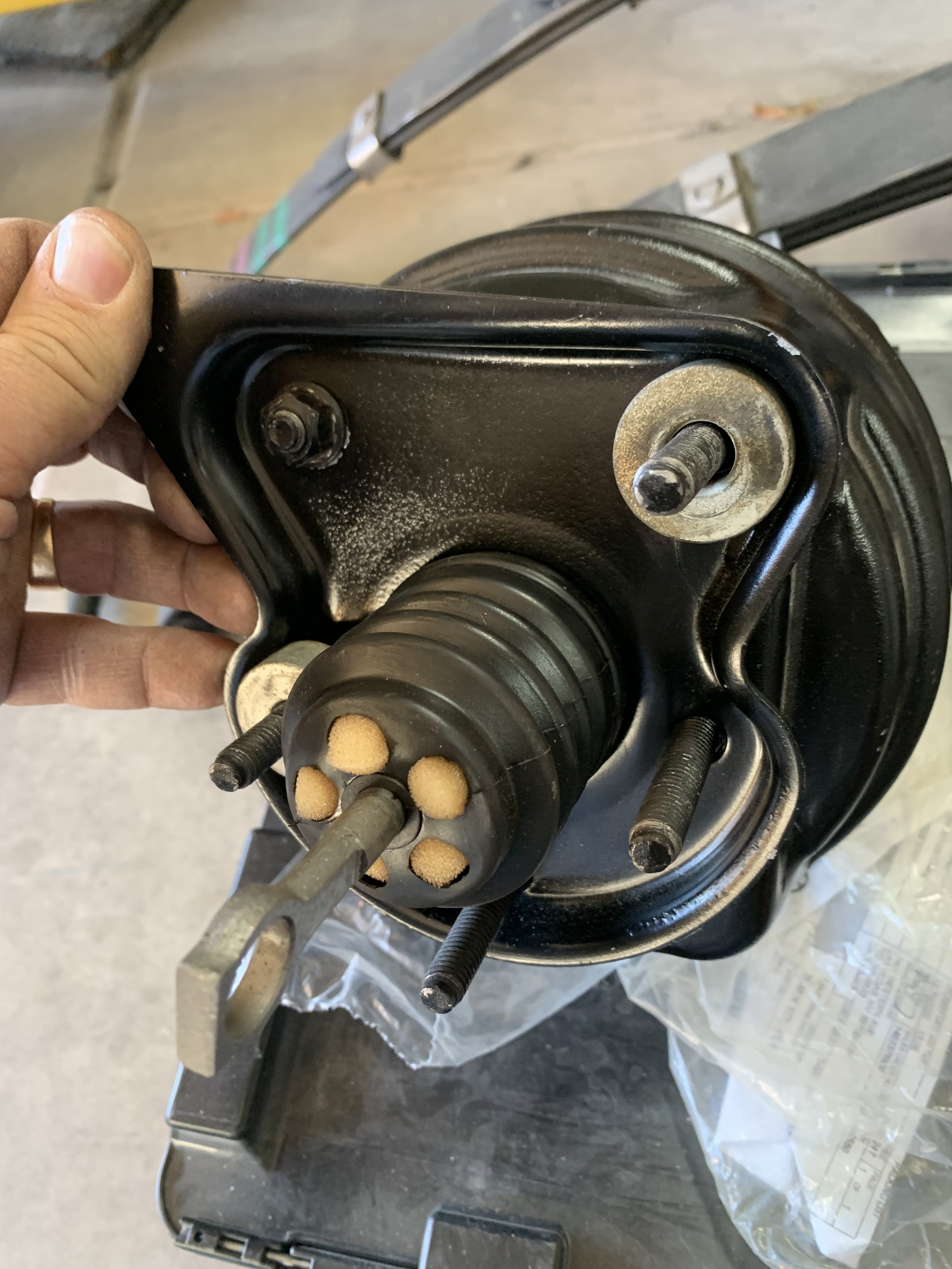

Booster Steve did this one.
It was done “at a shop in San Carlos”.
If that’s your booster, it has the wrong push rod for a 70. The teardrop rod is for a 69. I believe the pedal geometry is different between 69/70.

The 1969 power brake booster was installed on my 1970 Cougar, and when I finally got it out of the shop (after four years), the brakes barely worked. There was no power!

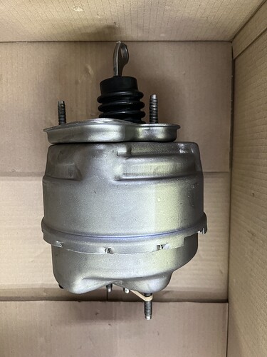

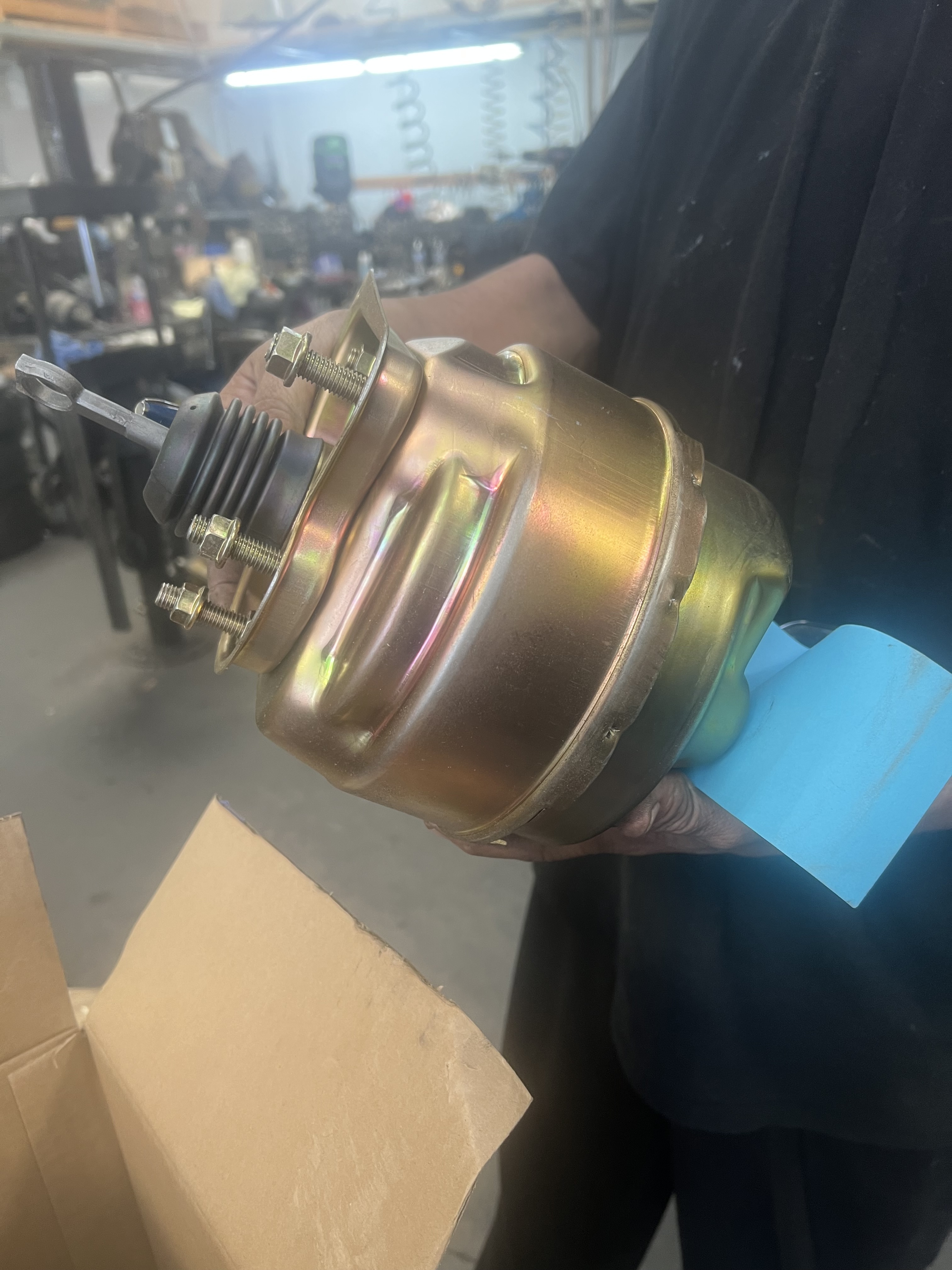

I informed the shop that the Cougar Forum had ID’d this booster as a 1969. So the shop sourced another rebuilt booster from Nevada.
It looks to be a 1970, but it’s got no identification of make. The 1969 booster in my car now is Bendix.
Any ideas what type of booster, probably aftermarket, this is? The shop’s going to try to find out from the Nevada vendor.
The thing is, my brakes worked okay for >10 years prior to bringing it in the shop, but now everything’s freshly rebuilt and it doesn’t. The booster rebuild shop in San Carlos denies any possibility a 1970 was switched out for a 1969.
I wish there was proof of what booster came out. If it was a 1970 Bendix I’ve really been screwed, because now I’m getting a mystery meet booster.
We might be able to tell more about that booster from a picture of the front side. It looks like the remanufactured one my car had on it when I bought it. It worked fine for 10 yrs or so.
