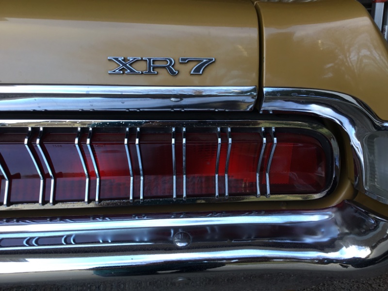

Would someone be so kind as to give me the appropriate location of the XR7 emblem located on the trunk lid for a 1970? I greatly appreciate it.
Dave,
According to WCCC
We often get asked about where to place 69-70 XR7 and Cougar adhesive emblems. Based on personal experience and pictures from the original Ford archives the answer would be “Pretty much wherever you think looks best”. Often as seen in this picture the line workers did not even attempt to get them very well centered. Both emblems were placed on the RH side of the deck lid “somewhat” centered.
I can get you measurements from mine if this does not work for you
Measurements from the right to 7 and from trim to bottom of XR? Thank you.
1/2” from emblem bottom to top of deck lid trim and 2 1/8” edge of 7 to deck lid edge. On my 70 I owned back in the 70’s, the X was located directly above the 4th tail light bar - a little bit farther right. So they definitely varied in location.
