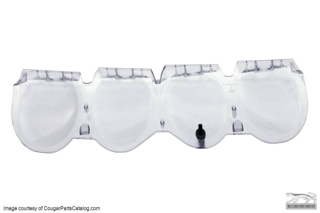

Not having a lens in my hand , is it possible that they could be reproduced in small quanities using sheet as described and cutting on a cnc router or even a laser. Sheet usually comes protected and plexi is avail with a/r anti scratch coating that holds up quite well. Just a thought
Looks fairly complex but easily made with injection molding of acrylic plastic.
Just an FYI, there is hardly any area of this lens that is flat. About the only area is the short section between each gauge pod. The area over each gauge pod is curved. At the top of each gauge pod the plastic makes a 90 degree turn and extends down to connect with the plastic gauge housing. There are indents where each of the attachment points are to attach the lens to the housing. If someone were to make a replacement lens out of flat plastic they would need to come up- with a new way to attach it to the plastic housing.
Don tells me that this would sell maybe 15 per year. Not good. Usually I try to split tooling over about 700 units (or more). Here is a thought: use 3d to print everything but the parts that have to be clear. Use flat clear lenses as inserts. It won’t be a commercially successful product but it might make a few people happy.

You are right about the lens’ concave/convex properties, but the rest of it is just to “place” the lens as molded, properly. While I know you think this may be crude, my lens has been in the dash now for over 10 years, is dust free, and works. Yes, I would like to have a factory part, but all the ones out there are ridiculously expensive by themself, or even more if I buy a gauge/lens package. I love Cougars to death, but, seriously, I built mine to drive and have fun in.
