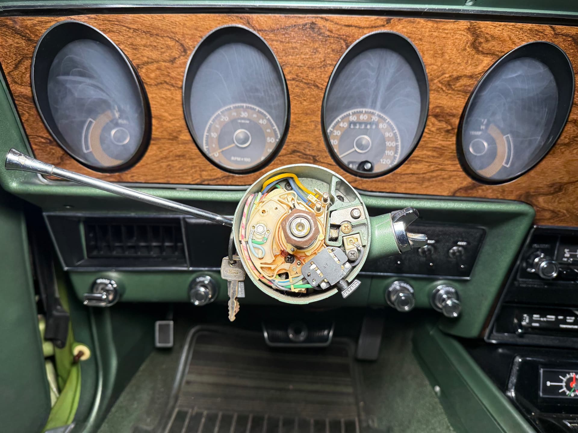

Does anyone make a reproduction instrument cluster lens for a 72 XR7? Or, is there a restoration service? Mine are clouded/discolored (milky) looking. Meguiars PlasX doesn’t work. The clear plastic lens has become clouded.
If they’re cloudy there’s usually nothing you can do.
The cloudiness is inside the plastic, not on the surface.
I thought these had been done. Maybe a Mustang part?
Mustang is not the same. This is a Cougar only part.

I know from time to time I sound real cheap, but I used my ‘72’s faded lens and traced it onto a sheet of 3/16” lexan. Double sided 3M tape to act as both a cushion and a positioning tool works for me. In fact, it’s invisible at night with the gauges shining thru! (and, no, it doesn’t attract dust)
