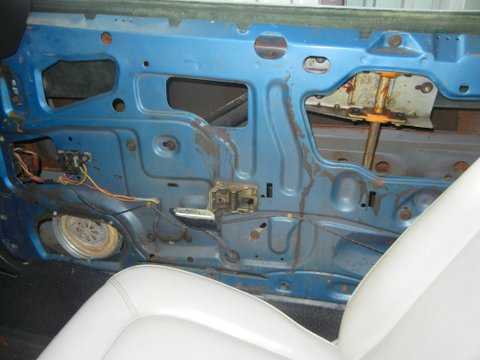

Don, thank you. I don’t mean to sound like a dumb**s, but when I removed the door panel all I see is metal with very small opening. Just don’t want to screw anything up. Thanks again.
The door openings aren’t very large, but post up a picture so we have an idea of what your are seeing and we’ll try to guide you from there.

Mike and Don, sorry it has taken me so long to post the picture. I guess the first step is to get the after-market speaker out of the door. But after that, I would like to know which nuts/bolts need to be loosened and how to remove the window motor. any advice you can give is greatly appreciated.

So is it two bolts or three that hold the motor in? I don’t want to loosen anything that I don’t need to. Hate to have to adjust regulator.

The power window motor is bolted to the window regulator. You will need to remove the regulator from the door and then remove the motor from the regulator. The regulator is held onto the door by 4 bolts, 7/16ths socket as I recall. You will need to have a second set of hands to do the job. When you go to unbolt the regulator from the door the glass will want to fall down, which risks breaking it. And power window glass is different from manual glass, much harder to find replacements. It’s a pretty easy job.
