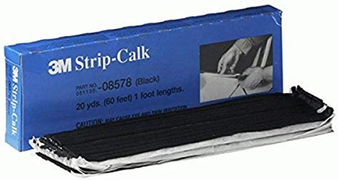

The factory used rope caulk to seal around the tank flange, and also on the stiffener board under the spare to adhere it to the tank top.

Oh and I also keep a box of that 3M strip caulkin the cabinet ALWAYS, as I use that on everything that I build.
