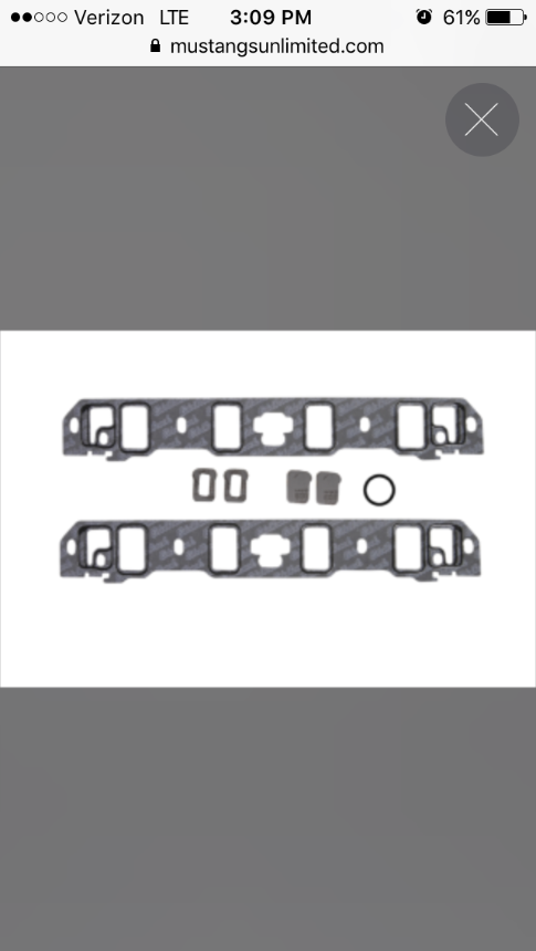

Here is pic of gasket used.
I didn’t use any of the small pieces shown in the picture. Not needed right?

There are several different water port setups through the years on small block fords. The one you’ have looks more like a 351W setup. I think the 289 water ports are narrower and don’t have a bolt hole through them (someone correct me if I’m wrong). There are 3 or 4 different configurations, so it’s easy to get the wrong one. The ones I used looked a lot like the ones you have, but I’ve got '69 351W heads on mine (along with a Performer 289 intake). The engine rebuild kit I originally used had several different styles in them and that was the one that matched up the best. Some list the port sizes to differentiate between different configurations.
…and the procedure you used sounds like it should be fine.

As noted above, the pictured gaskets are for a 351W. Bigger port openings, and different water passage shape. They’re similar enough that you still might get them to seal, but you’d almost certainly be better off with actual 289 style gaskets.
Ok. Thanks. Summit speced then for 289.
Summit, unfortunately, isn’t always a reliable source of information when it comes to old Ford products. Something like this would work better for you: https://www.summitracing.com/parts/fel-ms901031
