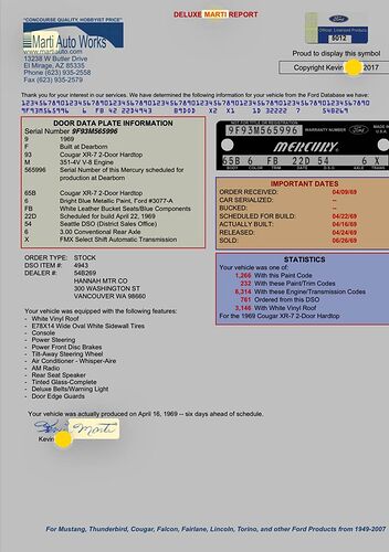

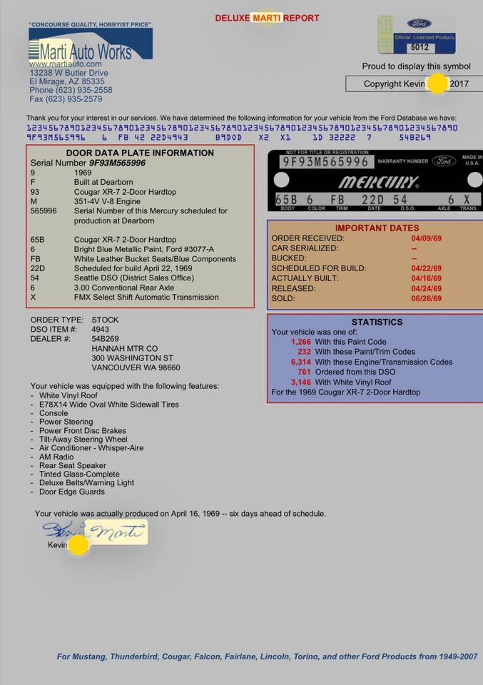

What should the car have? Do you have a Marti report or a means of decoding the door dataplate info?
Yes
The other wheel turns the opposite way
What do i need to do to make it a possi rear end? And where in the Marti report does it tell me what rear end is on the car?
For Marti Reports go to the website, and it is self explanatory.

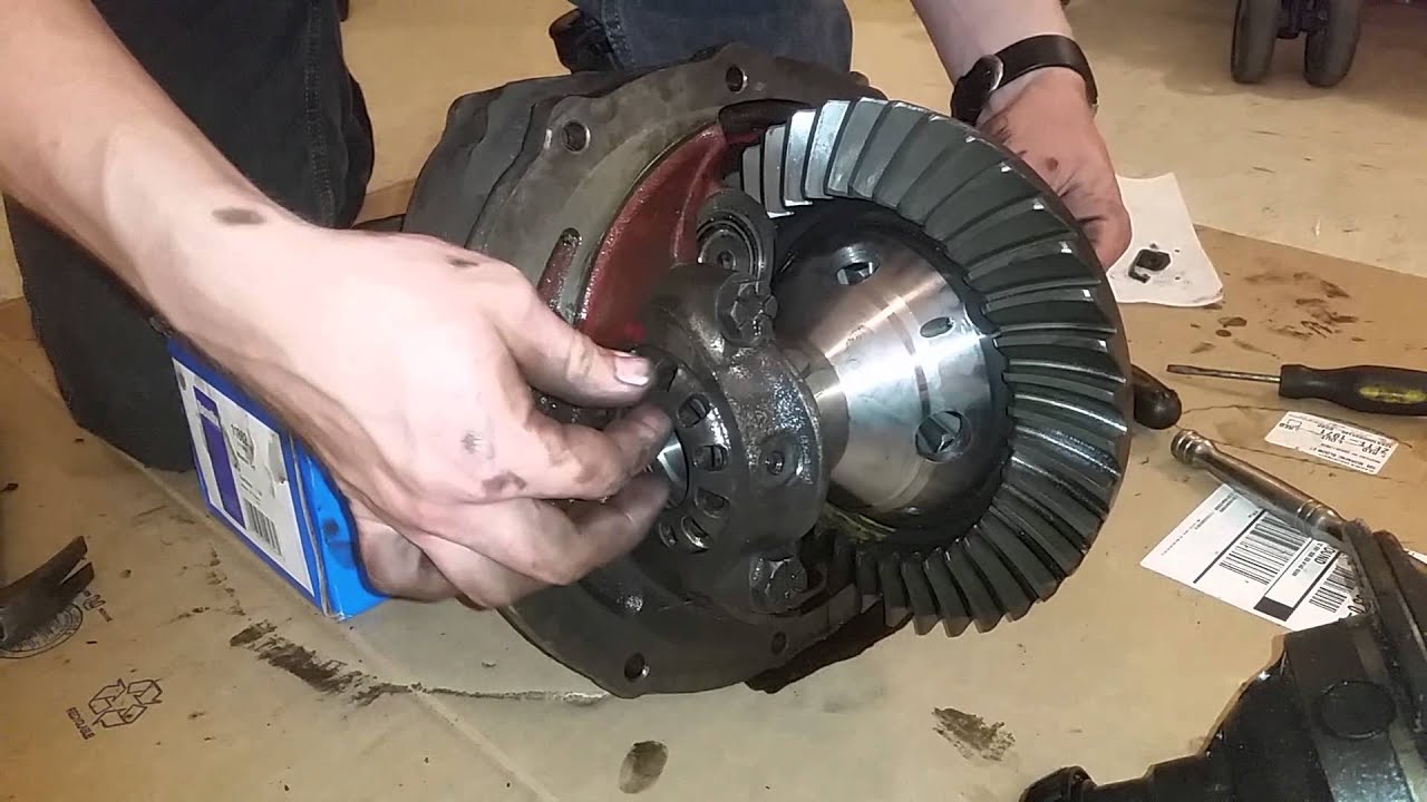

Posi, is not as simple. YouTube will have many videos. Look for Ford 9 inch
Traction-lock rear ends were very rare in these cars. I’ve had 20+ 69’s and only two were traction locks. Even big block cars were often open rear ends. Your door tag will tell you what you had originally. If it was an AC car, probably had a 3.0 open.

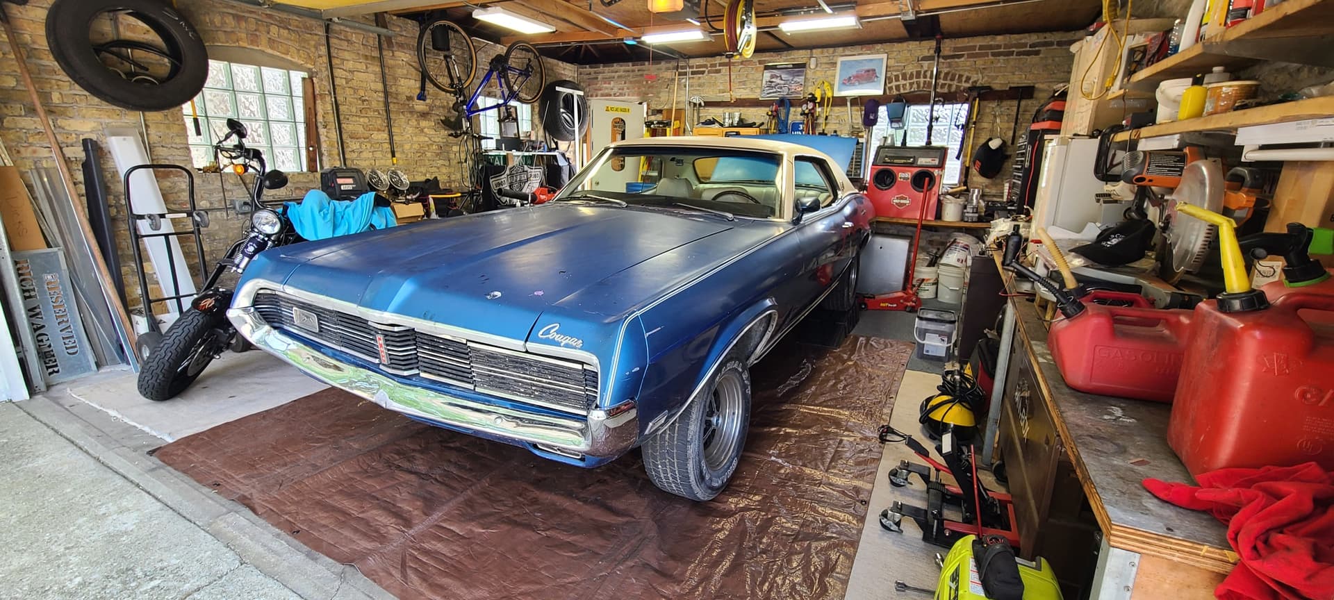

Looking at the Marti Report, it sounds like you have a very pretty Cougar. Do you have any pics to post?
Cool pic. Nice garage.
Saw that car for sale on FB. Looked like a good buy.
Correct its a nice car.
