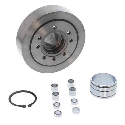

find an after market balancer. yours is old, buy a new one. new ones will have both bolt set ups
