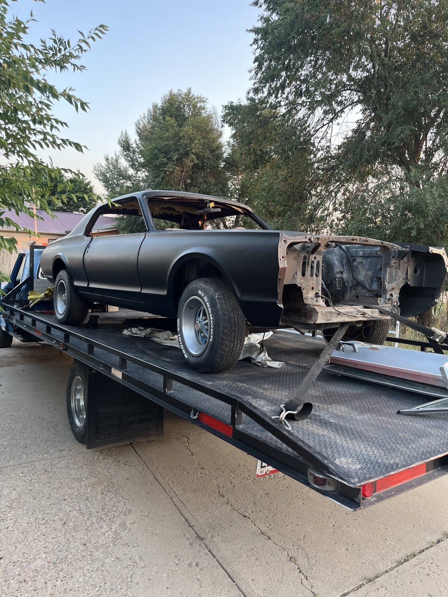

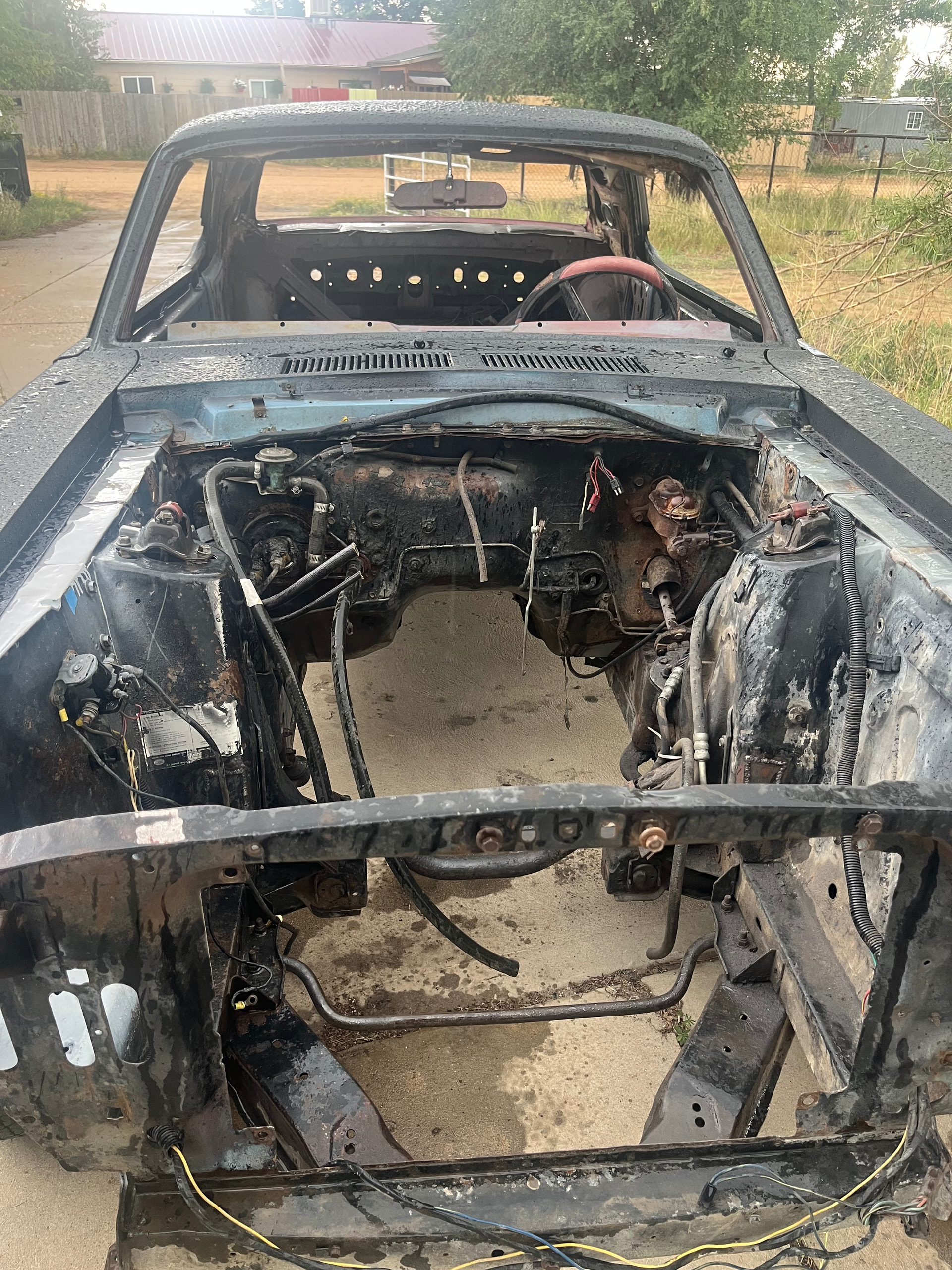

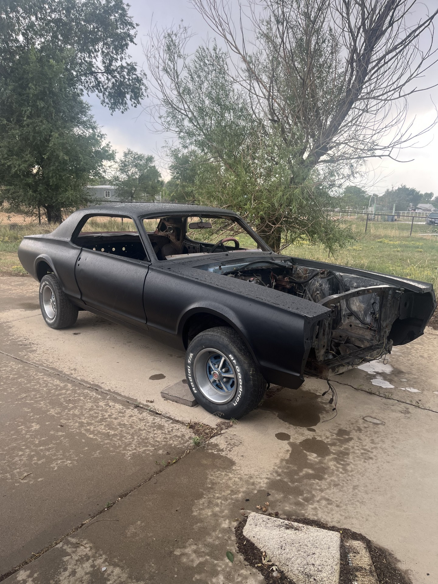

Well, it came back from sheet metal a week or so ago, and now begins the nearly impossible task of finding all the pieces, all the hardware, all the new parts, and trying to put it back together. I have most of the big items for it, but the devil is always in the details- Which way is this, does it go this way up? That kind of stupidity. I thought I should start a new, long term thread, as this is going to take me a long time to get back together. But, I have to hurry up, as I need the car to at least be “yard” driveable before the end of the year, as a I am planning on moving back to Idaho by November. Just because it’s the plan, doesn’t mean it’d going to happen, but that’s the goal. Anyway, here’s some pictures of it, as it sits right now-

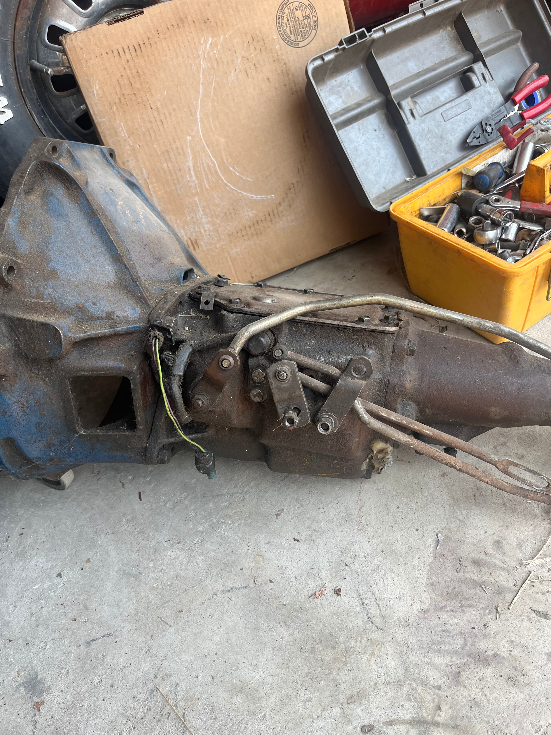

The car has new rear leafs, or slightly used at least. I got them from a guy here in Denver, 5 years ago. The rear end has been rebuilt, with a locking center section and 3.55 rear gear in the 8 inch diff. I have a freshly gone through toploader 4 speed for it, and the still waiting to be started fresh engine. That is a .030 over, 302 with a comp .500 lift magnum cam, and flotek heads. F4B intake, and my fetish carb 3259 715cfm Holley. I agonized for years, literally about what headers to use, and finally pulled the plug on the stainless tri-y’s. Just because the car is “rare” by color combo doesn’t mean it’s more valuable- nobody cares about a 2V 289 C4 car. So I am taking liberties with the drive line. It will get paint and interior back to stock colors, but I want to enjoy driving the stupid thing, too. I have accumulated a lot of parts over the years, now I just need more time, and more money, to get it all together.

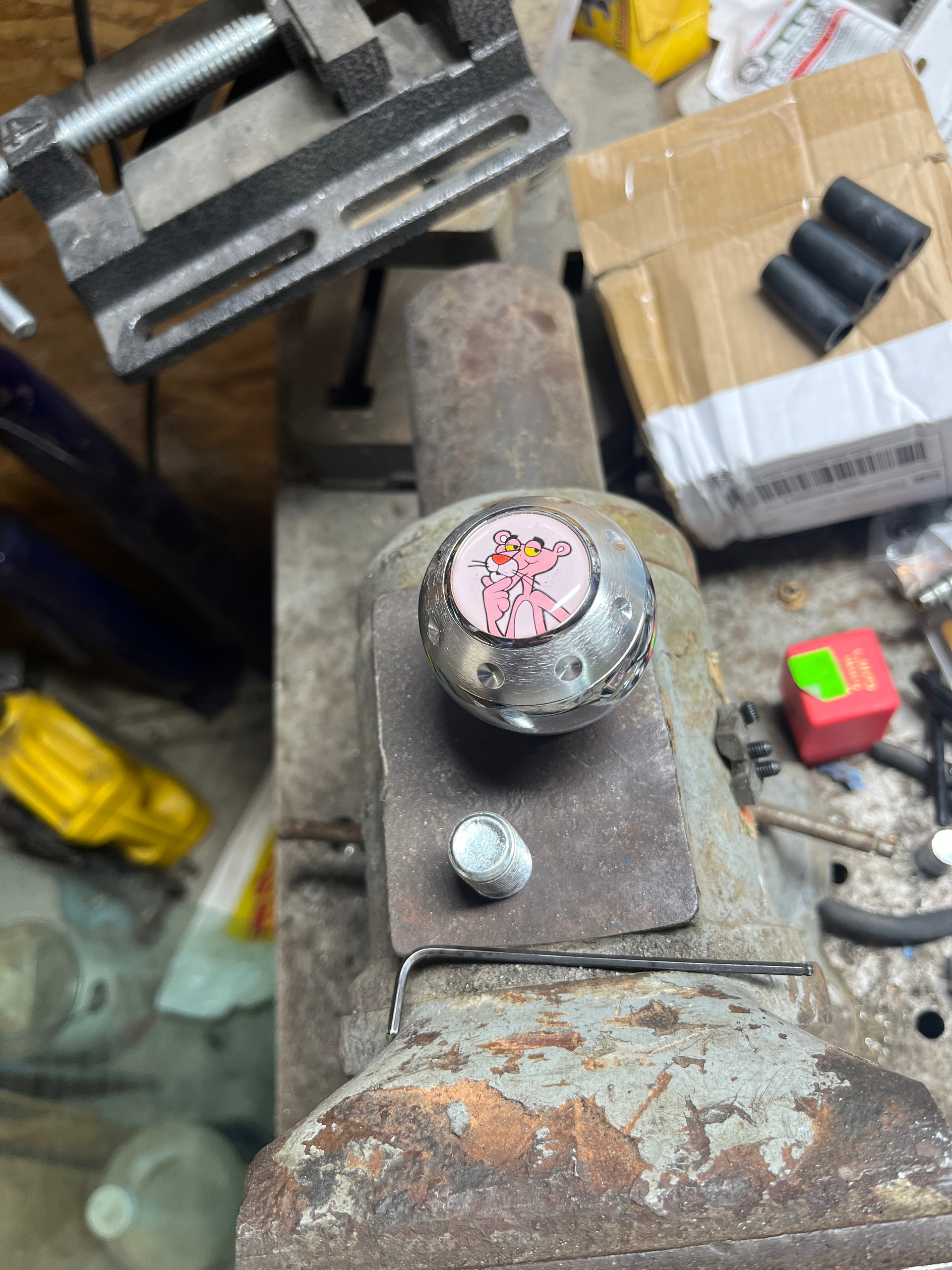

One other thing- I had the pink panther shift knob on my watch list for a very long time. I didn’t need it, as I have other knobs available. But in a moment of weakness, I bought one. I didn’t see the “universal “ fitment, until it was too late. So if you think you want one, you will have to get a bolt to fit, and then drill and tap for your shift lever thread pitch.

Your 3-4 shift lever is on upside down…just in case you didnt notice.
