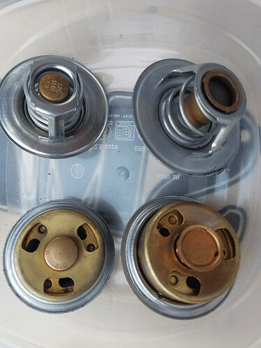

Sounds like the classic 351C thermostat bypass issue. I had previously confirmed that I had the Robertshaw type thermostat and thought was correct for the engine. Pulled the thermostat today and discovered that it is not the proper thermostat for the 351C. I’ve seen the discussions on the thermostat types and on the restrictor plate before but my previous Cougar (351C-2V) had never had an issue and up to now neither had this one (351C-4V). I’ve collected some spare thermostats and a WCCC restrictor plate and was contemplating changes (perhaps even a new water pump). What I found was some subtle differences in thermostats. The first picture shows four thermostats. The top two are the conventional design and the bottom two the old Robertshaw pressure balanced design (now available from FlowKooler & WCCC). The two on the right have a top hat like collar on the temperature bulb and are correct to the 351C with the bypass orifice. The collar blocks flow through the bypass when the engine is hot (the bulb moves downward as the thermostat opens for the main flow). The orifice is 0.750" dia. the collar 0.675" dia. There is still some leakage (less than 20% of the orifice area). Without the collar the flow area is only reduced by 50%, allowing significant bypassing when it should be closed. Some internet searching indicated that Ford designed the bypass to provide some circulation in warm-up and avoid potential hot spots in the heads. Some people have had issues (presumably with the correct thermostats) of overheating with the bypass leakage and a restrictor plate (see second photo) is available the replace the orifice and block the bypass flow (except for a very small air bleed hole).

There are the pictures. I had to really shrink them down
Went back with a correct thermostat (the Robertshaw type w/ collar) with the bypass orifice still in place. I believe this should be sufficient to counter the high temperature at high speed issue that I had. Time will tell.
It may just be the angle of the pictures, but are the thermostats on the left the same diameter as those on the right ?

All four have the same overall diameter where they mount on the block.

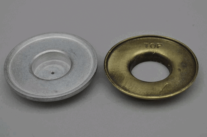

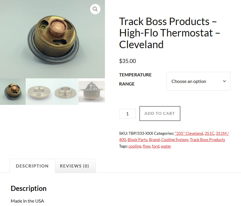

Just for information, TMeyerinc.com has exact thermostats for the 351C called “Track Boss” and in 160, 180, and 195 degree options. They also have the replacement brass flow restrictor that goes in the block under the thermostat.
I’ve been using the TMeyer bypass and the 195f thermostat since 2017 as the final step in completing my cooling system upgrade. Lot of freeway miles and long, slow car cruise events (little to no air flow other than the fans themselves) without issues. My dual electric fans, when both run at full speed and the car stationary, rapidly drop my water temps down to mid 170s at 90f ambient.
Thats the best price I’ve seen for these!
I found out about TMeyer through the DragBoss Garage YouTube channel. He recently did some videos on Cleveland cooling issues. Just thought I’d pass it along when I saw this discussion. I just joined here.
