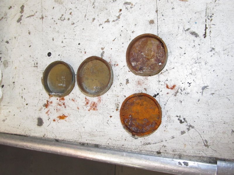

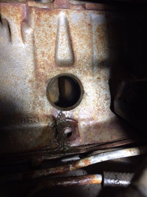

Phew… We got lucky on this one I think. I had to remove the starter to find that it was a rusty freeze plug and rather easy to get at for one of those. The screwdriver went right through it and we pried it right out. Will get a new one tomorrow.
I had the same problem on mine. However, and here’s a warning for you; the freeze plug hole was corroded quite bad as well, so the only way to properly plug the hole was to use a block heater there. Works well and could be easier to install than a new plug. Good luck.

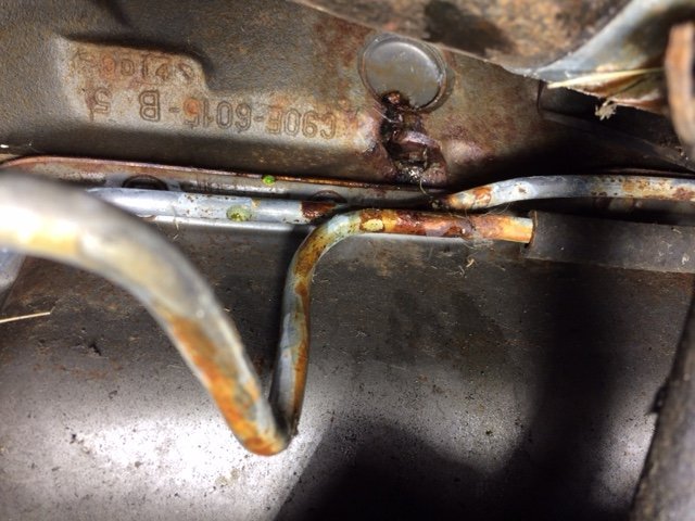

Here’s the pix I forgot to attach last time. The starter has a thick coat of rust on it from dripping. I think there should be a tube clamp where that threadhole is?
Looks like it was installed backwards.

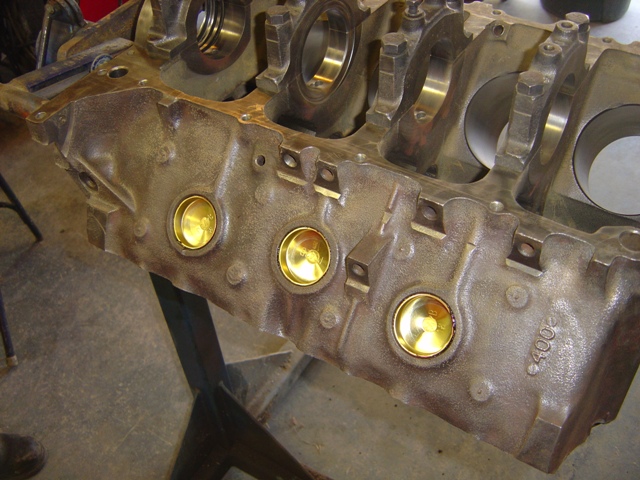

Best to use brass freeze plugs as replacements.
Looks like the right way to me (but the photo is deceiving).
The light from the angle and stuff catches all kinds of things, but I hope that’s not actually a crack below the plug or the new one isn’t going to fare much better than the previous one. At any rate check it closely when putting the new one in to optimize your chance of simply replacing it being the answer.
Use Dorman’s thick/deep freeze plug they drive in straight w/ a socket & a extension. The one shown is the thin one.

It was bass ackwards.
That pic was right after pulling it, we cleaned it up later and put in a new plug, and no crack. It was just surface rust on the block. The new plug wasn’t brass but it was much thicker, heavier and polished.
Was the cup of the plug facing outward or inward?
[/quote]
It was outward, like normal…
[/quote]
[/quote]
That was what I thought, the picture you posted can be deceiving. Thanks.
Umm, no.
