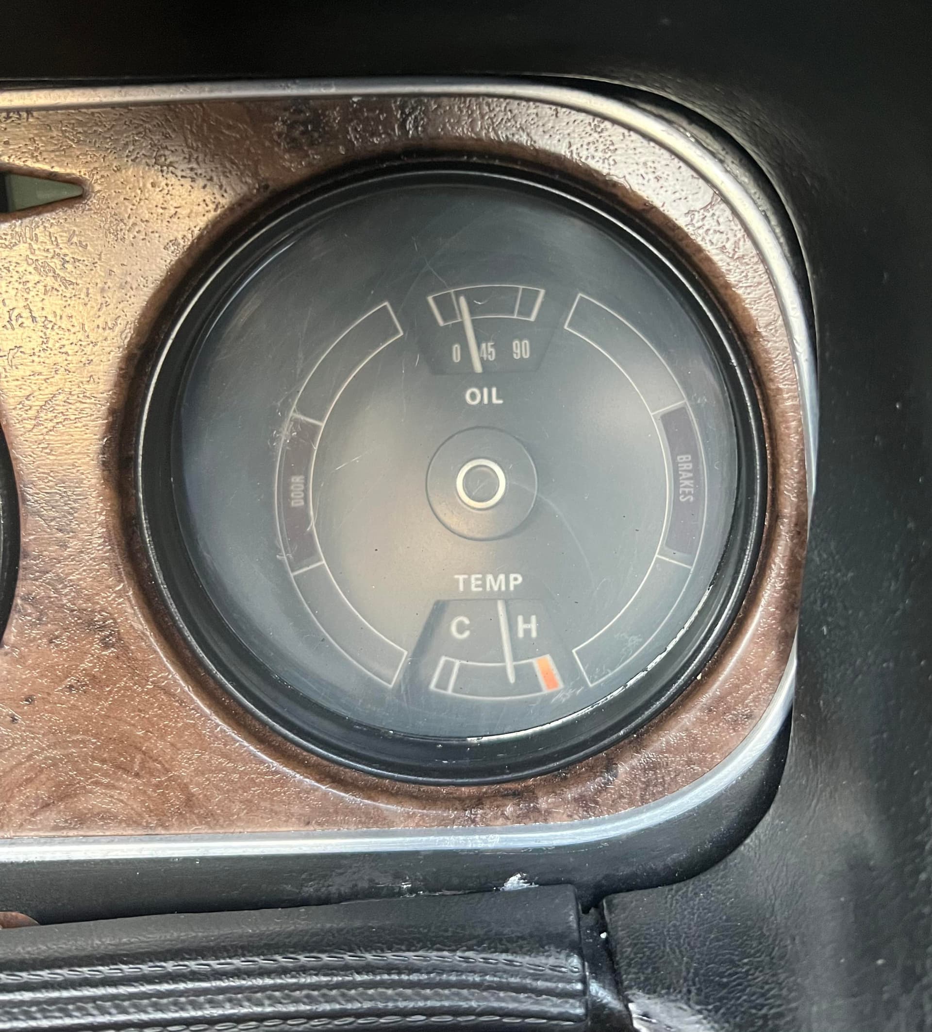

With my 351W, the gauge used to stay right in the middle or slightly below last Fall/Winter. Creeps up when 80+ degrees out and after driving for 30-40 minutes or in traffic. Now, in the Fall/Winter I do have a Heater Core switch which I open to let more hot air into the cabin…that is currently closed. Will try again with it open. FYI, a new 160 degree thermo and system flush were just installed/completed (before that it was going right up to the red line but never passed it when really hot out…90+).
Running too hot or is my gauge just not accurate??? Do I need a new sending unit???

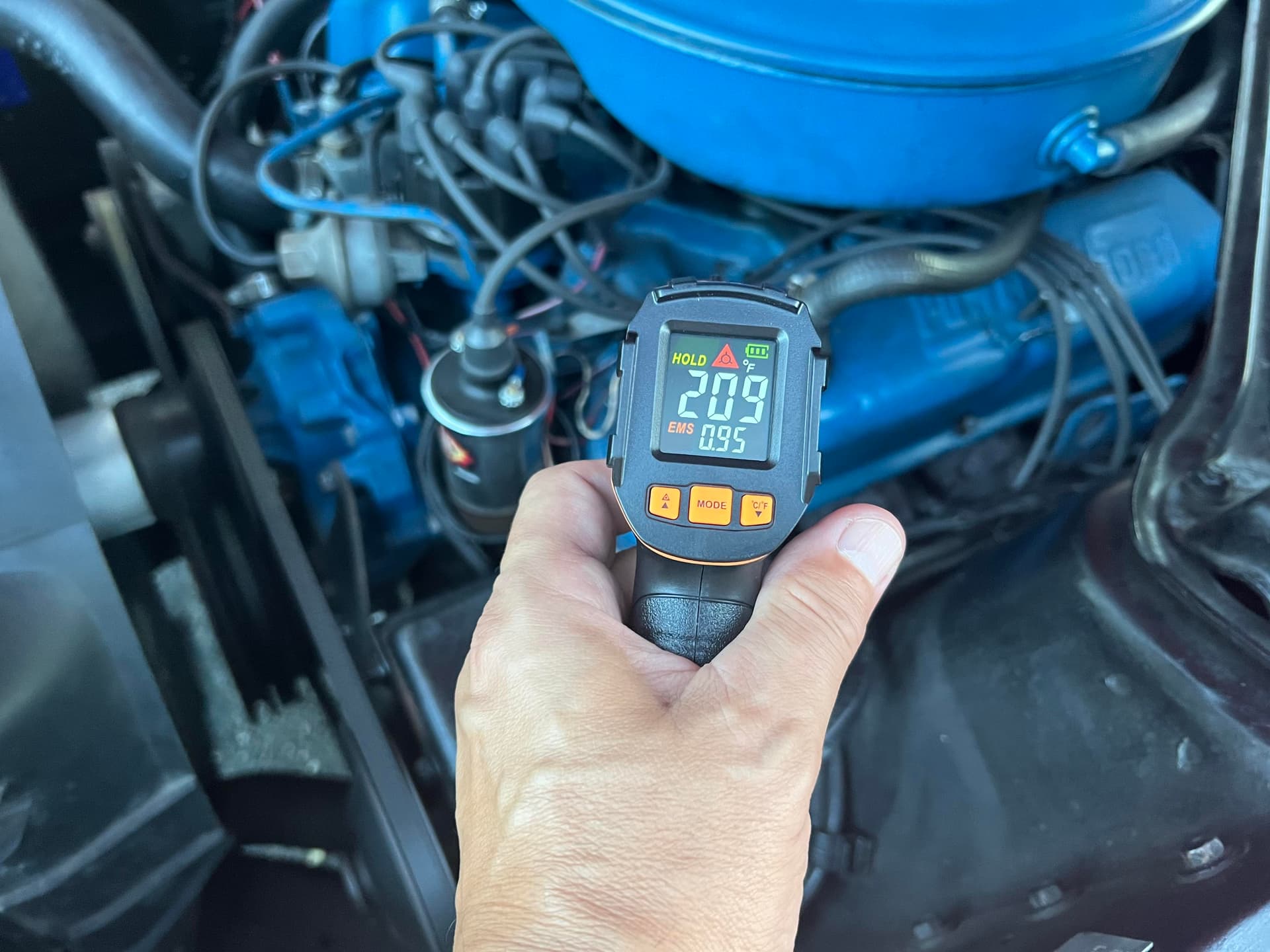

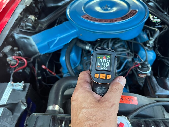

It is reading roughly 190-210 with the thermal…that is not unusual, correct?

190 is where you want to be but with a 160 thermostat it should read 160. Keep in mind these are all plus or minus a bit.

Thanks…when they flushed it out and replaced the thermostat they thought it was fine. Since the weather is getting a little cooler I flipped the heater core switch in the engine compartment pushing more into the cabin…it is running around 180-190 now but sometimes the gauge still pops up towards the red…I am starting to think it is the sending unit or the gauge itself just reading inaccurately???

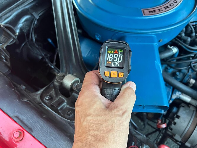

It is now running at 180-190 with the heater core switch opened up…that is not really overheating, is it??? I drove for 30+ minutes the other night and it did not even get to halfway on the temp gauge…so weird…
No, 190 is about right. But, what happens with the heater off? If you need the heater on to hold 190 with a 160 deg thermostat, something isn’t quite right.
