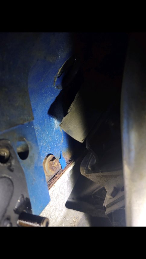

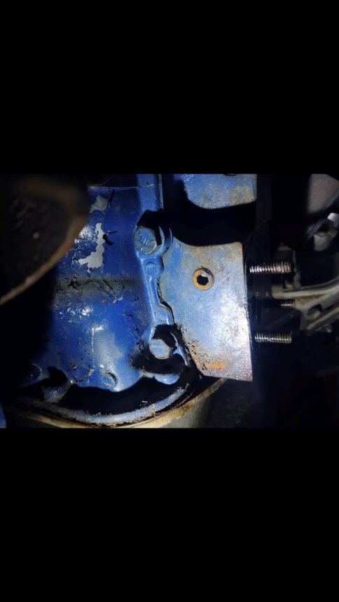

Here is some pictures of C5AE-A block. Is this a center oiler or side oiler? What block casting would have came in this 1967 cyclone? Thanks
Is this c5ae-a block a center oiler or side oiler? What block casting would have come in the 67 cyclone 427
The original block in a 1967 427 Mercury Cyclone would be a side oiler with steel screw in freeze plugs.
Could be either depending how the casting was machined.
I assume it should be just like this

Picture shows a side oiler.
Your 67 Cyclone would have likely been born with a C7 solid lifter side oiler block. I’s quite a rare block. I have one on the shelf for my 67 R code Caliente. Bill, you and anyone else has my perpetual permission to use my name and phone number. Ray Bischoff 248 867-3522. I’m in S/E Michigan.
