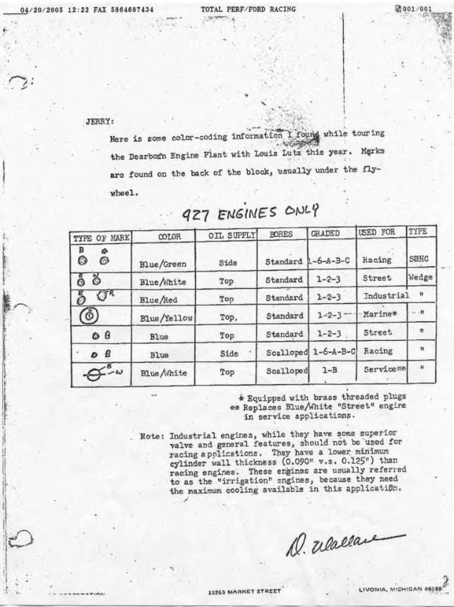

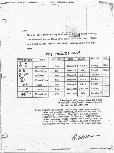

Easy answer - no it has been replaced. 1967 Fairlanes, Cyclones, Galaxies, Marauders and 427 NASCAR engines were all side oilers with screw in freeze plugs.
Here’s the Fomoco internal memo on grading FE blocks.
A 1967 Cyclone could have been a W code or R code engine. In either case that engine would be a 427 Medium Riser solid lifter side oiler. Lots of flolks who don’t know better and lots of crooks who will say otherwise.
